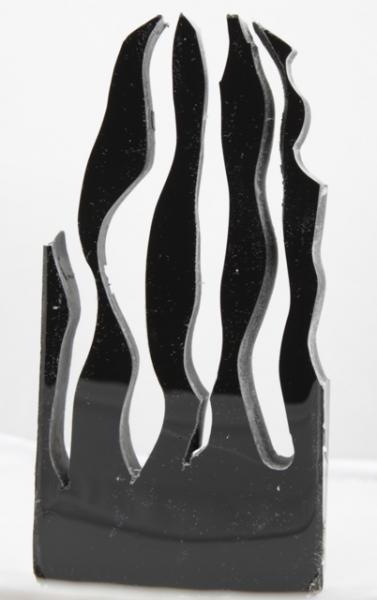

If I cast an all black blank out of alumilite, then cut flame patterns in it on my scroll saw, put it back in the mold and then pour in bright orange alumilite, will the 2nd batch be rejected or cause problems with the already hardened, black?
Ok, here is the first cast, and I cut "flames" out to add some orange/red. Will update as I go along!

From what I see, I'm going to have to say no sir, that's not going to work too well. In theory, you are close, but if that is what I think it is, it's flawed. Go to my website and click on the magazine article section, then click on the article for fret cast pens. That will put you more in the right direction. The main problem I see here is layout. The second problem is your bond support. Alumilite sticks to itself, but it does not bond to itself. It will seem like it is bonded, but when you drill it, it is very easy to break that bond because it isn't really bonded, just stuck. With small images placed inside and poured over, the stuck is good enough, but with something of this size, stuck might not be good enough. In a few months there will be an actual article out about how I cut my 360 flames in alumilite. It involves proper layout and the design is way different than what you have there..the design puts the alumilite into a situation where stuck is good enough. It's like the difference between using wood glue to glue wood end to end or side to side. We know that wood glued side to side is bonded, adn wood glued end to end is only stuck together meaning it is easy to break it apart.
As far as rejection..there will be no rejection when you pour over it. You are going to have a unique blank with what you have made there. Make sure you pour over the blank, not just level with it, but a good 1/8" over the top of what you have cut. Otherwise the pressure will push down into the cuts and you will have big voids. Just like what you experience in the corners of a square mold, that will also happen into those cuts if they are not over poured. When you drill the blank, be extra careful. If you build up too much debris inside the hole, it will pop the blank apart at the cut seams. Once you get it drilled and tubed, you should be in good shape. Spin the blank mostly to size then rub your fingers over the seams. If any of them are not completely flush, that means the seam has broke free. Use thin CA and simply pour it over to solidify the seam, then finish spinning to size and you will be successful.
Thank you Jeff. I have poured the 2nd coat and cut it in half, tomorrow I will try to turn it to see if I can make anything out of it.

For your scroll saw, you should use the largest blade possible for the project at hand. When I cut little things like 1/2" wide skulls with eyes and nose and mouth, that is all done with a #5 polar skip tooth blade. The saw speed should be relatively slow, not super fast. Let the blade cut. Think about using a hacksaw on a piece of metal. Would you cut through faster at high speed or slow speed? At high speed the teeth will just skip over the metal, they need to go slower so they can bite in and then clear out. You also need to turn the material, not the blade. This is why you have uneven cuts in your flames. Improper turning technique is why you are cutting an arc as you move..hard to explain..but I see the flames you cut..I can see the top and the bottom of the "board" and well lets say just say the width between flames is 1/4 on top but only 1/8 on the bottom and they should be uniform, but they are not because the blade is bowing as you are making your turns. Because you cut too fast, too aggresive, maybe too small a blade I dont know your blades, and probably not enough tension too. Slower with more tension and proper technique will allow you more control. Slow way down when you get to the ends of your cuts up in the points..I see your blade plung into the plastic and the next cut up does not meet with it. In otherwords your flames don't come to a perfect stopped point. Reminds me of when I first started scrolling! We probably all scrolled like that at one time..it takes some practice, like sewing.:biggrin:

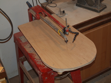

Eventually there will also be an article for building a table for your scrollsaw. To cut tiny pieces, you need a false table. This is for safety and so you don't loose what you cut.
Pic 1 is my zero clearance table. Not sure when that'll be published..its' waiting in line because I have several articles pre-staged in line waiting for their turn. It uses cauls and wooden handles to hold it in place, so it is easily removed and the top panel can be easily replaced if it was to become too damaged. I do not find I need to replace the top too often, but that's all going to depend on your skill level. If you push hard in all directions, the blade bows and eats the table.

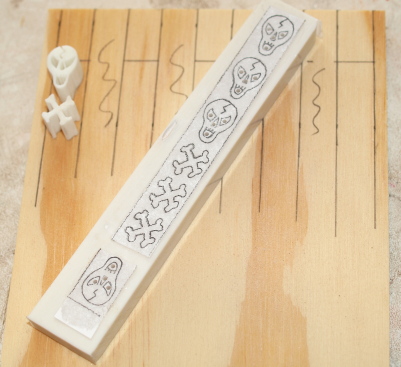

Pic 2: This is some skulls. You can see there is a specific size peice of plywood I use..it is 4 7/8 wide. If you deduct 1/8" for saw kerf during layout, that means you get 5 blanks at 7/8 wide each and each skull sits in the center of each blank <that's theory...the skull might sit a hair off one side or another, but it's going to be close to the center enough that you will be able to locate the true center when the blank is harvested and be guaranteed more than enough safe room for drilling. Each skull as you can see is cut from a piece of alumilite that is 7/16 thick and is placed upside down on the plywood. The plywood is the face of the blank, so anything placed on it must be upside down. I slice the block at 7/8, then I flip the block and the plywood goes on the fence and I trim the resin so that it is straight and parallel with the plywood, then the last step is to remove the plywood without barely touching the resin, leaving a finished blank.

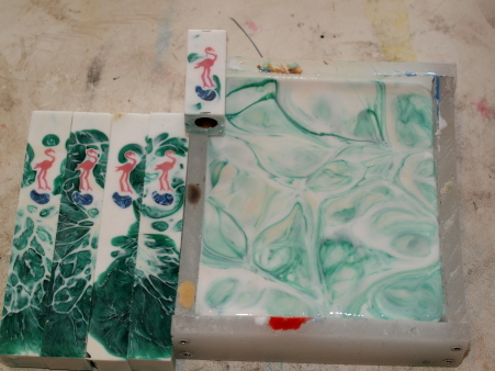

pic 3, you see the frame. This is the cutting board frame that simply surrounds the plywood bottom and is taped on the bottom. The resin you see inside the frame is accompanied on the left side by the finished product, pink flamingo's. This is a two tone white with a tiny touch of green. it looks like there is way more green than there is, but the green that is on the face of the blank is very shallow and will spin away..looks are deceiving with pouring blanks as resin flows according to weight and the weight of the green is more than the white, so some of it flows a thin line down the wood is all. As you can see on the block still in the frame, there is not much green there in reality, and even less when you get inside.
