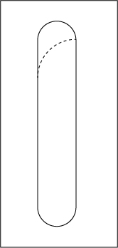

I sort of cut the bottom of my sticks in a way to get into that corner and the bottom. I'll post a pic later today.

Here is what I do. the way I cut it lets it get into the corners.
I also point the other end to scoop Pearl Ex.
