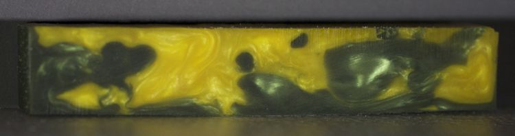

This blank is four mixes, two green and two yellow mixed together.

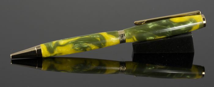

Here is the finished pen

Just a fair warning for folks trying this for the first time: by the time you notice it gelling, you have about 45 seconds before it clumps up. The pour above, as soon as I noticed it gelling we mixed and poured the yellow and by the time the it was mixed and poured the green was solidifying so I got that clumping you see.

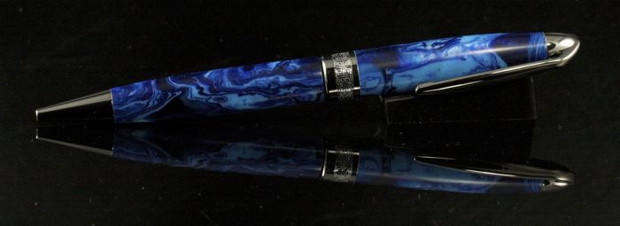

This was done with white alumilite and a couple drops of blue alumilite coloring. I mixed the Alumilite, added the drops, did some quick swirls with a stick, then poured.
So was that all from 1 cup or two? (pouring half out then adding the color counts as 2). i.e. did you pour a white and a blue, or a white with swirled blue?

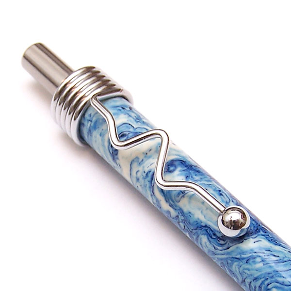

Oh, and this is Alumilite swirled. The color combo isn't what I was shooting for, but the color definition is nice. Mixed in two batches and poured together into the mold. No swirling with a stick or anything.
