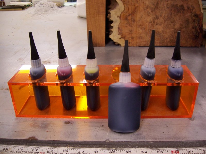

Get some empty CA bottles and transfer your Alumilite dyes into them. The use the tip that comes with it and cut it so that the hole is as small as you can. This will allow you to very easily and conviently use the bottle as a dropper and not have to mess with the eye dropper. It also allows you to have small drops for smaller batches.
I believe, in talking with Mike (VP at Alumilite), that they are re-doing their packaging on the dyes to be more like what I am saying. This is based on feedback that I have been giving Mike for a couple of years. They have to go through all their old bottles first, though.
Also, if you need to, you can thin the dye with part A or if you want it even thinner, use some odorless mineral spirits. This will make it more liquid and allow it to come out of the bottle better. BTW, the bottles are not meant to be full. You are buying 1 oz of dye. The bottles they use are much bigger than 1 oz.
As for messy, if you do what I say above, you will have no mess at all. I do agree, however, that if you try to use it as they ship it, it is very messy and a PITA.

I bought the large bottles and poured the dyes into smaller bottles for everyday use. With the long nozzles you can get really nice little drops of dye.
Here are the bottles I use and believe they are similar to what Curtis mentions above. This was an idea passed on to me from a good friend so I wanted to pass it along again.
