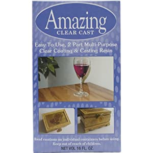

It does. Having never used Alumalite ( I'm grabbing some at Michael's today) when mixed, is it watery like PR or is it thicker? What frustrated me about PR was doing a 2 color swirl. It was watery at first so i was afraid the 2 colors would just blend together instead of swirling but still remaining as 2 distinct colors. As I mentioned I havent been about to nail down the exact moment where it thickens but still pourable. I missed that moment and wound up with 2 single color bottle stopper blanks.
Unless your Michaels carries some thing else, I don't think thats the same Alumalite (clear or white) that everyone here is talking about.
I do think there is a product there that is made by the Alumalite company but its not the same Alumalite that everyone here is talking about. I did check it out once and I think its an epoxy resin.
I'll try to find the thread here where I asked about it.
Here it is http://www.penturners.org/forum/f43/so-confused-alumilite-question-134356/
This is not what people are talking about when they say Alumalite.
