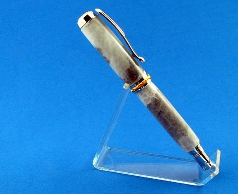

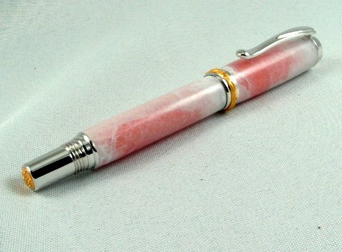

Hey Chris, Check out my classified ad: http://www.penturners.org/forum/topic.asp?TOPIC_ID=27628
The second photo, two pens on the right side are ones that I made from alabaster. There are several other pictures of finished pens on here that have been made from the alabaster that I have sold as well.
And yes, you can use your standard wood tools. Alabaster is a very soft stone and can be turned very easily. It can get brittle the thinner you go though.

Mannie are you getting chips or cracks when assembling or when turned? I haven't had this when turning but have had hairline cracks appear when pressing together. I have used thin CA after turned to size then finished with MM to 12000, brasso,mequriers plastic polish and a final coat of TSW. The thin CA hardends the alabaster. When assembleing if when you press the parts into the tube and your press presses on the alabaster you will get these hairline cracks or chips so to help lessen this press both sides of the tube at the same time so as to have even pressure on the tube and not on the alabaster end that has no hardware.... I'm sure this is clear as mud LOL...
Cav, I bought my alabaster from Richard and its real alabaster not a tru-stone product
Thanks for the response Roy, I didn't see the question in time.
William, as Roy said they are true Italian Alabaster. You can definately tell a difference when turning. When turning alabaster all you get is a very fine dust. I have used CA on my alabaster pens and it has worked well for me.
