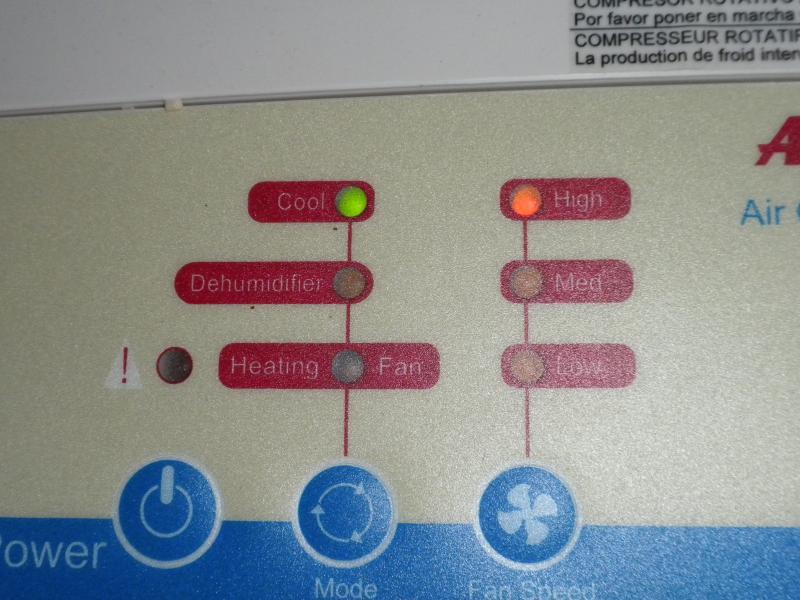

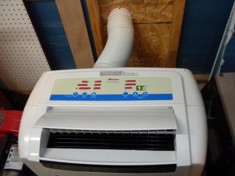

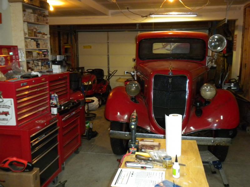

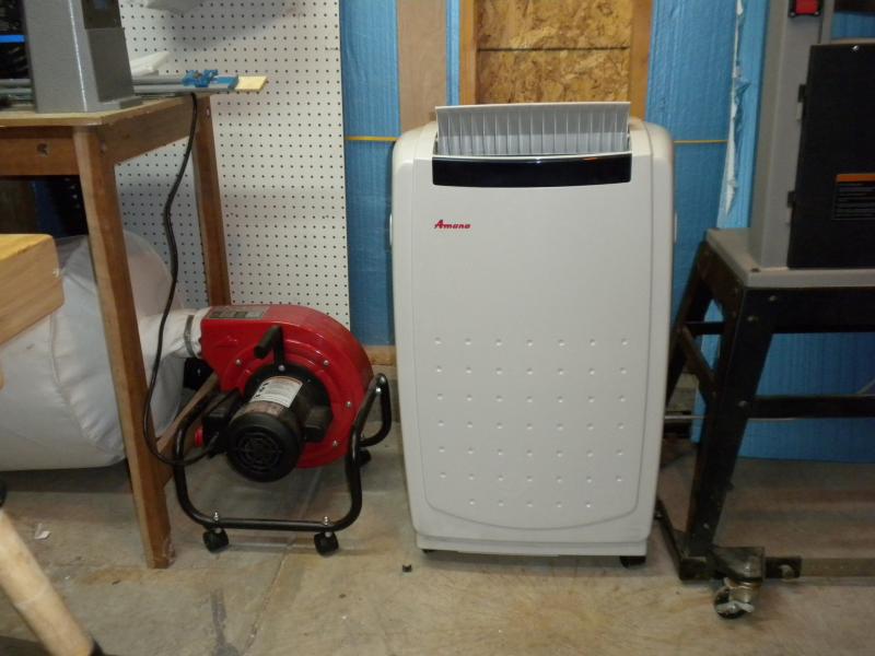

OK, I have to chime in on this one. About 3 weeks ago I was working in the shop/garage and it was 86 outside and about 91 in my garage. I told the wife I need to cool things off in the shop. My garage is L shaped. It's 2 1/2 cars wide and 40 feet deep on the outside wall. My shop is in the back half and my antique fire truck and misc items sit up front. The garage is 90% insulated I just have one more roll to install up front.
Anyway I spent the better part of a Saturday going around looking at portable AC units and they all seemed just to small to handle my garage. My last stop was HH Gregg and they had an Amana 15000 btu Ac, Dehumidifier and heater all in one setup. I bought it on the spot. I had to make a 4 inch hole for the exhaust there is no condensation drainage as the unit evaporates the moisture and blows it out the exhaust. I hooked it up and turned it on and set the thermostat to 70. The next day my shop was a comfortable 72. Yesterday it was 92 outside and the shop got 74. I run it non stop 24/7 and its on the same circuit as my whole shop. I run the AC, Lathe and dust collector all at once with no problems. I LOVE my cool shop now! :biggrin:
