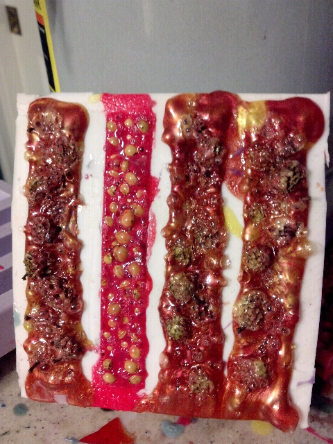

agggghhh! Moisture!
Buzzzz4
Dec 7, 2008
2,761
Grand Rapids, Mi
Just in case you were wondering what humidity and other condensation can do to Alumilite.
I've read many people say that alumilite is so much better than PR but lately I have seen that a lot of people are having problems with it, ie. wrong dyes and tints, moisture, etc. I'm glad I am sticking with my plain old PR for making blanks and worthless wood. JMHO.
Yep, I have a small stash of those. There is no way to be totally sure it is dry. I have gotten to where I leave them in a 150 degree toaster oven for at least overnight and keep them in there till I cast so they don't absorb the humidity in the air.
