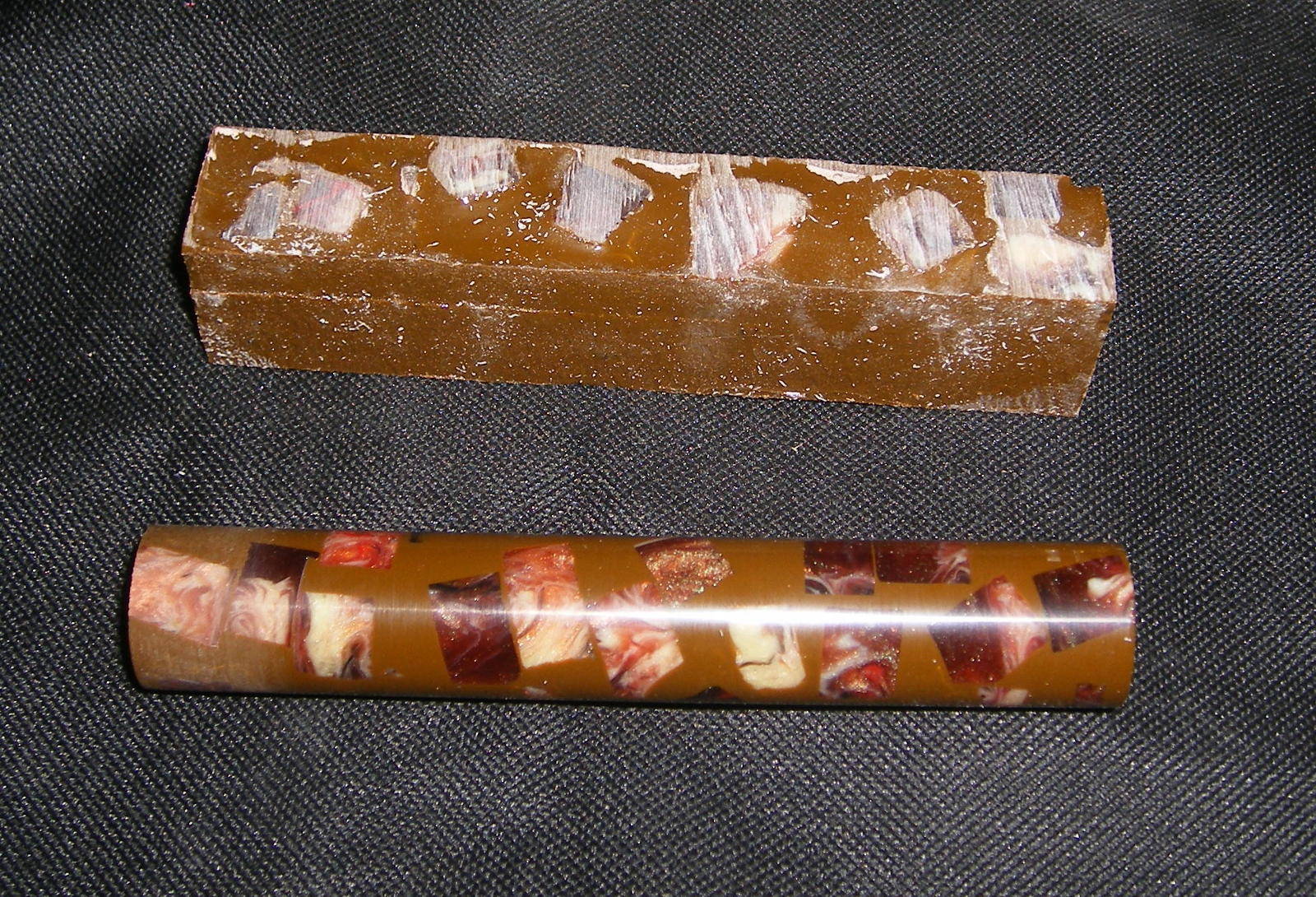

got made into a pen today. Sad story about this blank: I made them as a block of 6. I cut one off to make this pen. Then, I accidentally turned the block round 90 degrees and sliced it. The resulting blanks are barely long enough to make slimlines. I may have to make plain black bottom parts for these, or maybe perfume pens or other short kit. I took one of the stump blanks and hacked it up into little cubes and bedded those into brown solid PR. Just to see what it looked like. It looked like this:

This one is quite similar, but I made it a nice chunky blank for a big fat kit.
(Click for enlargement.) I'm really very pleased with that one. It got made into a pen here.

Much like my other blanks, these have been a dream to drill and turn, so the pigment hasn't affected that feature much.
