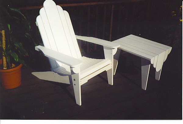

Sorry I missed your post. Check out www.woodmagazine.com for full size plans. I have made quite a few of the folding ones from their plans and everyone seems to love them. They also have quite a few different versions. I also made templates out of hardboard, rough cut on the bandsaw and used the router, bearing bit and template to finish off each piece. As far as finishing goes, the wood is more important than the finish for outdoor furniture. As Rudy Vey said, if you choose the right wood, even with no finish, the chair will last many years. Ceder, Cypress, Mahogany and White Oak are all good choices. If you need to use pine, the only way to preserve the wood is with a film finish such as paint or deck stain. Stainless screws and bolts, at a reasonable cost, can be found at Mcfeeleys (sorry I am not sure about the site address). The picture below is a folding chair and table I made from plans from WOOD Magazine. It is finished with solid white deck stain.
Enjoy, the chairs are a lot of fun to make. Easy too, you can make a set in a day.
