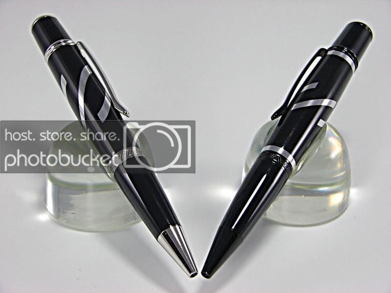

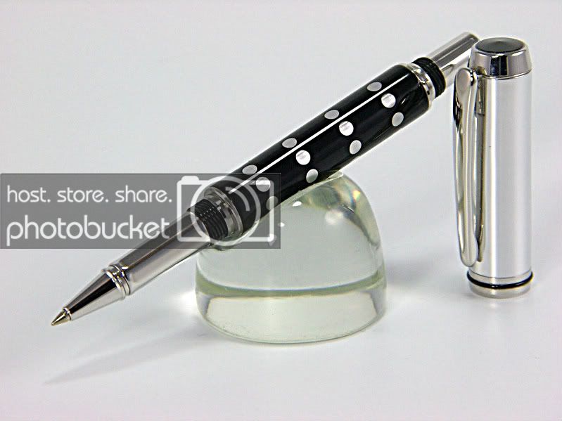

I cast my own. I have some black blanks that I bought years ago that I still use on occasion but did not with this because I started with a 1" blank. When doing segmenting I like to use larger blanks and blanks I am familar with. Silmar 41 is my resin of choice.
It has been awhile since I posted any pens and people here have forgotten that I do make pens:biggrin::biggrin: Will be changing that over the next month though.

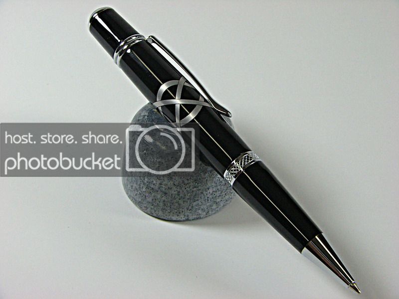

Holy smokes John those are great! The finish is top notch and aesthetically they're beautiful. The Celtic knot is one of the best I've seen, maybe THE best.

Bob, I only own wood lathes so I turn all my pens on them and aluminum is a metal that turns very well with sharp tools. I will use carbide tools now that I have them and still like to use my skew also. You will get chips and not long strings like acrylics but is easy to sand and polish. But if sanding it will cross contaminate wood products. I buy alot of my aluminum from Home Depot. Good luck.:)

Thanks for the kind words Jake. Yes I make them but don't tell Skip I stole the idea from him. Oh yea he already knows because I told him a few times:biggrin::biggrin:
