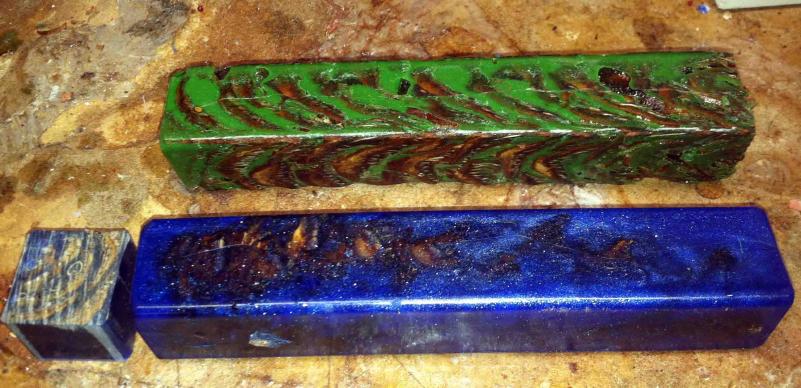

Here is a photo of an example, the top was cast in resin using vacuum, the bottom was using pressure. Both use the same type of resin and was kept under vac/pressure until the resin was fully cured (about 10 hours).
By all means, experiment with the products you have at hand and keep notes on your process and results :wink:
