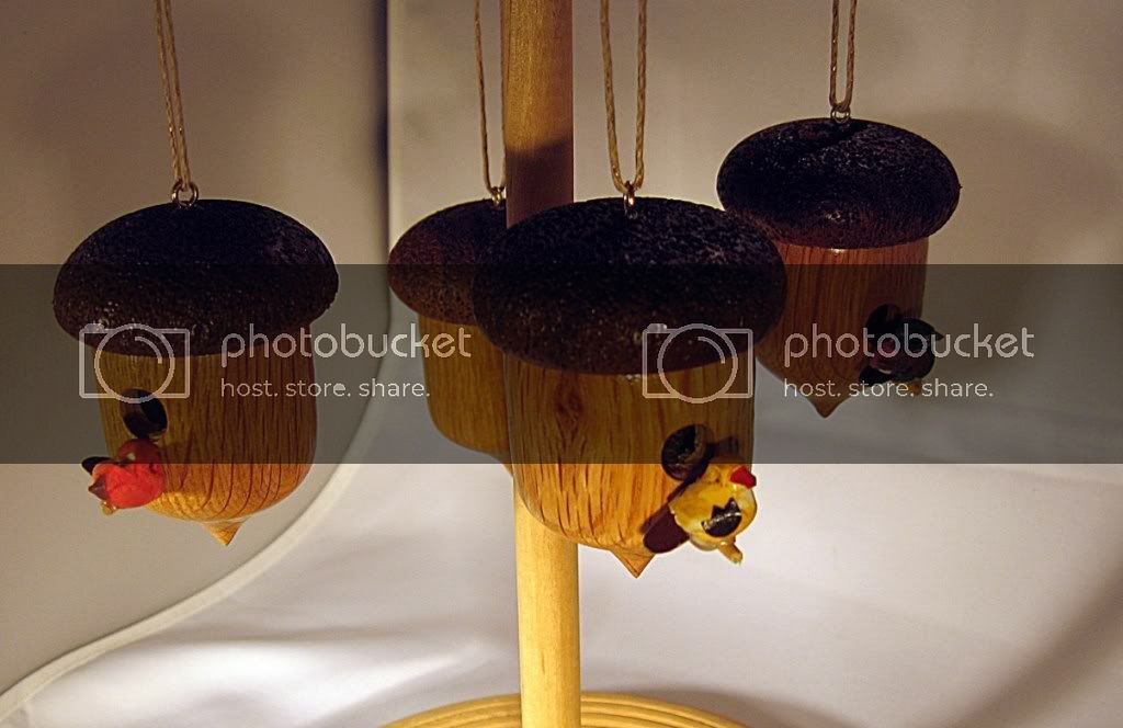

Made a dozen of these this weekend for an upcomming craft show. The walnut tops are textured with a pnumatic needle scaler ($20.00 at Harbor freight) I just sharpened the needles with a grinder
Comments welcomed. Thanks for looking

I recently took some classes held by one of your countrymen, Bob Rosand, and he showed the little trick with the needle scalers.
You mentioned sharpening yours, they came sorta flat so I just rounded mine over a bit. Do you find that actually putting a point on yours works better for the small work like birdhouse lids?

The birds are from a craft supply store (Pat Catans) I use a little round file to make a groove in them so they fit on the perch. The needle scaler points where sharpened to achieve the fine texture. I have to admit, its kind of fun using the needle scaler to texture with..the texturing took about 30 seconds for each one.

Where do you find the little eyelets in the top? I can't seem to find them around here.
Just sharing a little info......... A turner did a demo recently at our club and he used of all things....... fish hooks! They are cheap, available in many sizes and different platings.
He just cuts the hook off where it starts to curve and glues the eyelet into the top of the item to be hung.
