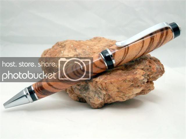

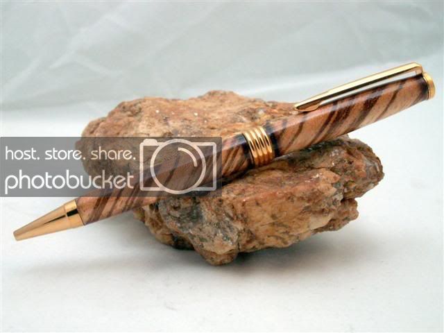

Never have a problem as long as I have REALLY sharp tools and I turn it at the fastest speed I have on my Nova Mercury and I glue up with CA on everything make sure you ruff up the tubes good I use a belt sander . ..Here are a few I have made below
I saw your pics in the gallerey.. They lok great.. I just blew apart 3 more. I am going to try a couple more.. If they don't work I am going to try the gorilla glue.. I now my chizels are not the sharpest they can be.. I suck at that. But they work good enough even on all the antlers I do.. So I don't think it is that.. Thanks all.. I to stubborn to give up on this.. I will win.!!!!

Dan,
Here is a cigar pen made from x-cut zebrawood (on the left).....
