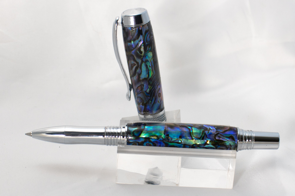

Here are a few pictures:
first image: 1.5 mm thick Abalone in1/8 in
second image: 0.17 mm thick abalone rolled onto tube
third image: 1.5mm thick abalone in 1/8 in strips
fourth image:
