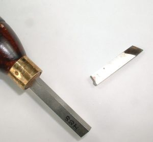

Maybe this is something I should have been aware of, but it never occurred to me before...
I was merrily turning away at a corian pendant. I wasn't particular stressing the tools or extending a long ways over the tool rest, but my mini-skew just snapped off!
Fortunately, it didn't fly very far or cause any other damage to me or the shop, but it still gave me quite a scare!
This had been one of my favorite tools and I've been using it for a few years, so I don't think there was any inherent defect in the skew -- I must have just caught something wrong :mad:
Be careful out there.
-Barry

I would bet there was a flaw in the metal and that it just finally worked it's way through the tool. not bashing the quality of your favorite tool but these things can happen. One fine example of why you do not want to go make a tool from just any type of steel. Just because they do not snap in half the first time you use them. there can be small cracks that are growing as they are subjected to vibration and bumps and bangs over time.

I'm glad you weren't hurt, Barry! But looking at the photo I have to ask. How close did you have the tool rest? Based on the location of the break, it looks to have been too far from the piece being turned.
Safety note: This is one of those things that can easily happen if you don't keep the tool rest as close as possible to the turning.

Looking at how much broke off, I had the same thoughts, but I don't think I had the tool rest very far. It's possible I was working at an odd angle, but not that I recall. In any case, thanks for thought.
