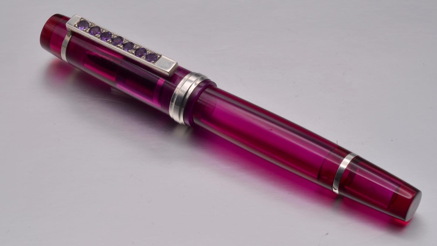

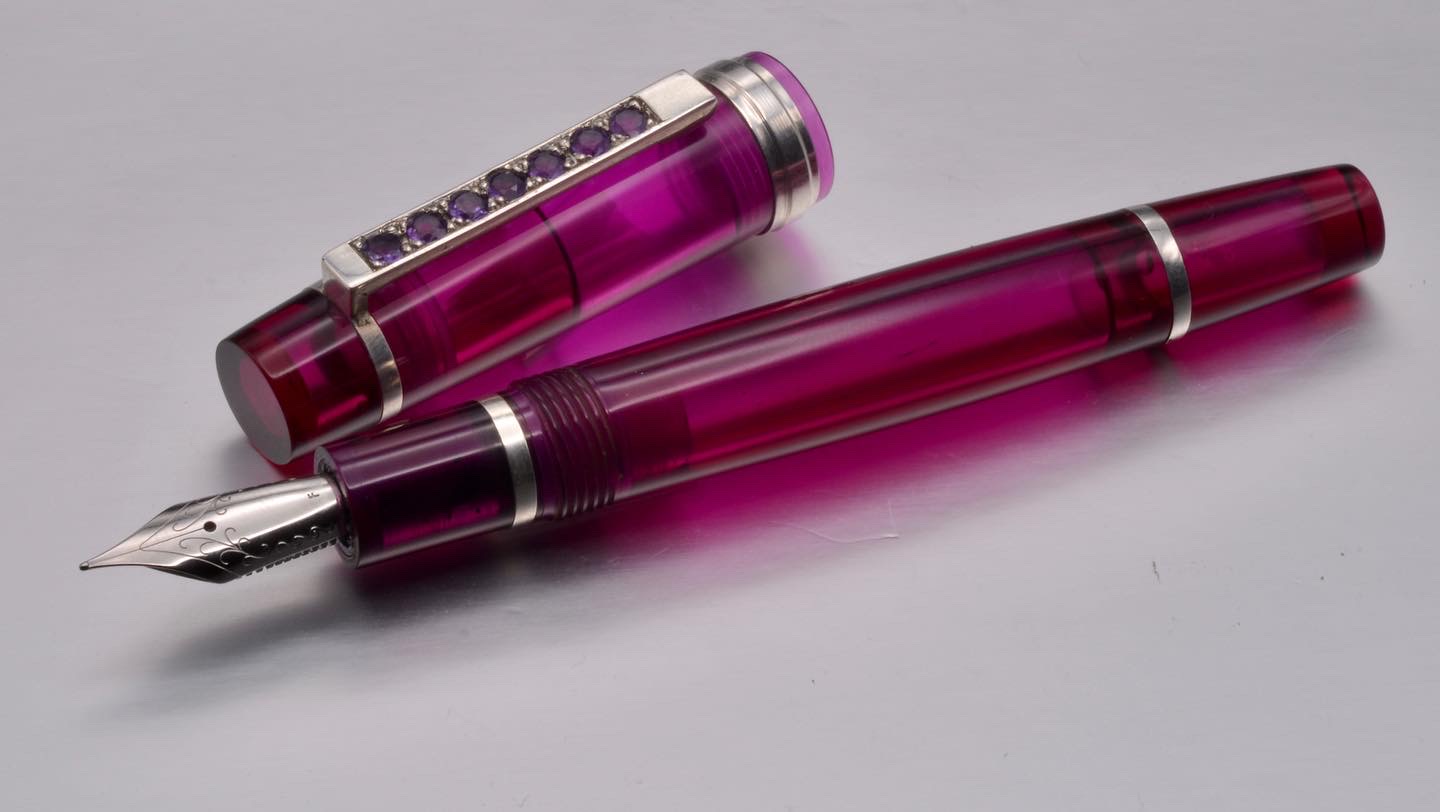

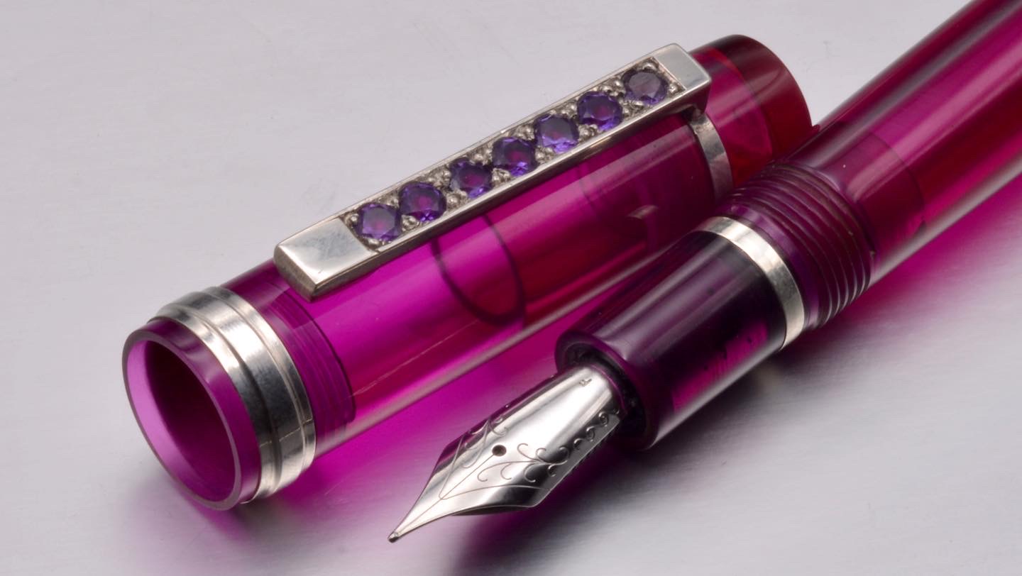

I just finished this pen, which I made from transparent purple acrylic, Argentium silver, and amethysts. Stone setting has been my latest skill to try learning, so I wanted to make a pen with some gemstones incorporated. I made the trim and clip from a large ingot of silver I cut down and rolled out to the appropriate dimensions for each piece. I set 4mm AAA grade natural amethysts in the clip using a traditional grain setting technique. The pen is about 5,25" long when capped, with 13mm cap threads .
