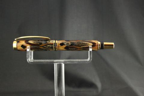

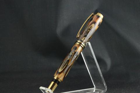

I have been jealously hoarding 3 feather blanks from John U for a while now. Last Tuesday I decided to turn them. They were all from the Jr. Gent II series.
The first five turned great. The last one, a top blank, blew out at the last minute. 1/3 of the blank was nothing but raw feathers. The feathers weren't damaged, but there was absolutely no resin on that 1/3 of the blank. Let me be very clear here: it was definitely operator error...there was noting wrong with the blank.
Soooooo........I put the blank aside, and later that evening as I was walking by it I wondered if I could recast it. So I mixed up about an ounce of PR with 2 drops of MEKP, put the blank in my ResinSaver mold by Charlie that fits the Jr. Gents perfectly, and poured in the resin. Put the mold in the pressure pot and let it sit for 24 hours at 50 psi.
Took it out last Thursday. Still felt tacky. Let it sit until today, and it was ready.
I turned it................and it is BEAUTIFUL. I will consider this one a SAVE. I've included pics, so you be the judge.
It was the top blank that blew out.
Thanks for looking.
Thanks for looking.
