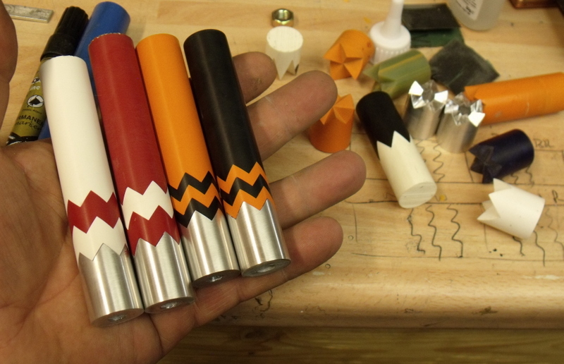

Just messing about segmenting metal to PR. It took these four half-blanks to get the set-up dialed in so now I will do the same with some fancier segmenting.....tomorrow. I think I need new eyes....really struggling at the moment. :rolleyes:
The red / white are single 10mm spacing and the black / orange are double 5mm spacing.
6 compound cuts at 45 deg and 15 deg. :biggrin:

Just CA John, as always. I also ALWAYS wash glue surfaces with degreaser immediately prior to glueing. Never had a failure yet.......:wink:

Did you use a CNC mill, with the workpiece mounted on a rotary table ?
Looks like you were using a 90 deg pointed cutter, and increasing the depth of cut at a rate of 15 deg from center to perimeter. Can't understand where the 45 deg comes in.
I'll think about it some more, but if you don't mind describing in a little more detail, I would appreciate that. Thanks

Mal, no CNC. I normally make these with a small router and my lathe to index.
Because I was using metal this time, I used my little mill. Yes, I used a rotary table to index.
The mill is tilted to 45 and the work is fed past the cutter at 15 deg.
Sounds more complex than it is......:wink:
