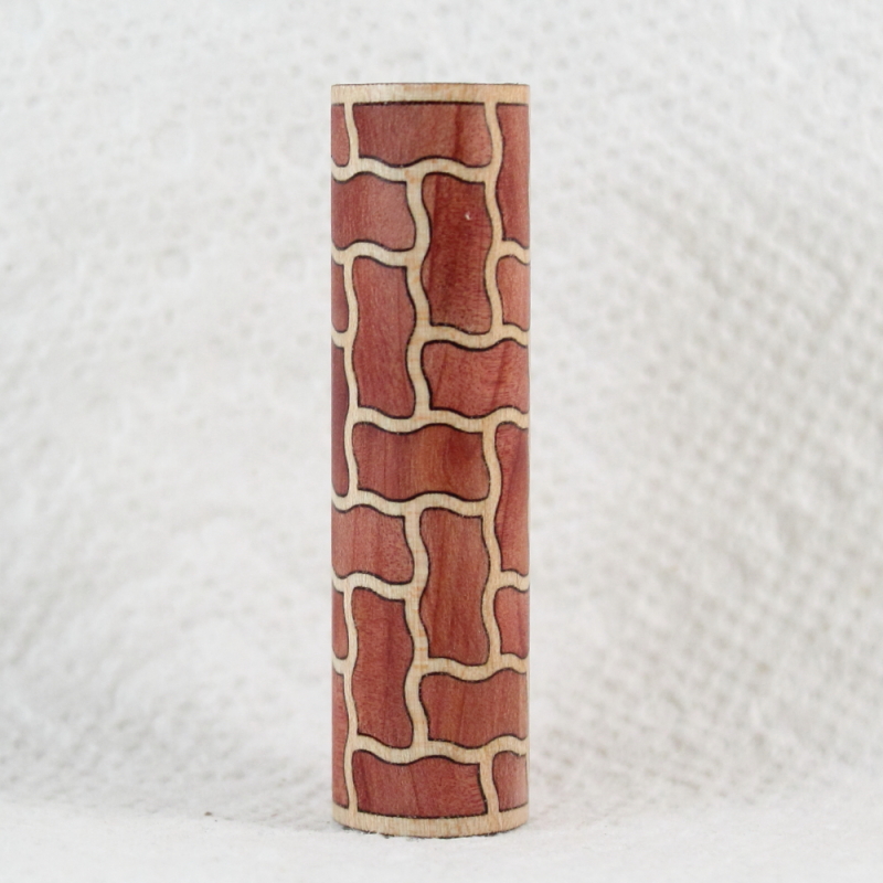

A Paver Brick Inspired Laser Cut Sierra Blank

The design of the inlays are roughly based upon a paver stone that I have seen. The blank fits Sierra style pens. The woods are maple and aromatic red cedar. There a 38 inlays that totally wrap 360 degrees seamlessly. I'm thinking about doing a second version and rotate the pattern 45 degrees.

A very nice looking design. Two thumbs up!
I would like to see it in some additional wood colors as well. Perhaps with the maple and Blackwood or Ebony.
I see you have to watch inserting the pavers as the grain dictates their orientation and having end pieces also.

Charlie, the pieces are cut in the round so there is really only one way that they will fit properly. Blackwood is a possibility but Ebony not so much, it's extremely hard to cut. A 60 watt laser moving at slow speed can't cut it in one pass, or even two or three. By the time you finally cut through the cut lines are charred pretty bad. I've read about people catching it on fire in the laser when trying to cut it. Blackwood on the hand will cut with a laser, it requires a little more power and speed than cutting domestic wood.

YES. I just got done doing a Chevron "block" and did not pay attention to the end grain patterns. The final slices were all mismatched and not acceptable. Live and learn.
