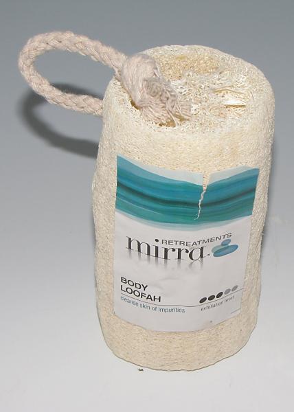

Saw this at the Kroger store and wondered how it would look cast in resin.

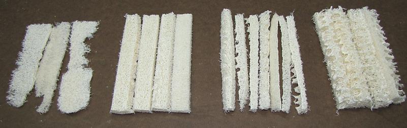

Took it to the band-saw and cut it up into as many ~3/4 x 3/4" lengths as I could get(4-far right in pic). bunched up 3 of the cuttings from the group 2nd from right to make a 5th ~3/4 x 3/4" length and fitted it all in to my 5 section mold. Filled the mold with purple Alumilite, Put the mold into my pressure pot and waited. (there is an oops here):biggrin:

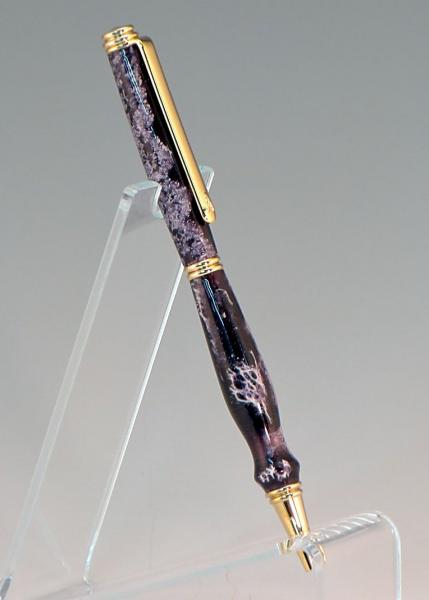

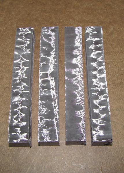

The results: (I think it kind of looks like purple marble)

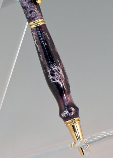

THE OOPS: Had a little difficulty with the pen, I forgot to turn on the pressure to the pot.:redface:
Had several little air pockets to fill with CA before it was done.:redface:
C&C appreciated.
I don't like Slim Line style pens, but I love the blank. Purple is a favorite color of mine.
SLs aren't a favorite of mine either but they are cheap and useful for prototype blank tryouts. This one happens to be CSUSA's Beaded pen but it is still a slimline style, the beads and the different clip can't change it that much. The blank was the fifth one in my mold made up of the pieces parts. Just wanted something to try the combo out with and on. With all the air bubbles in the blanks they all may end-up on cheaper pens.
