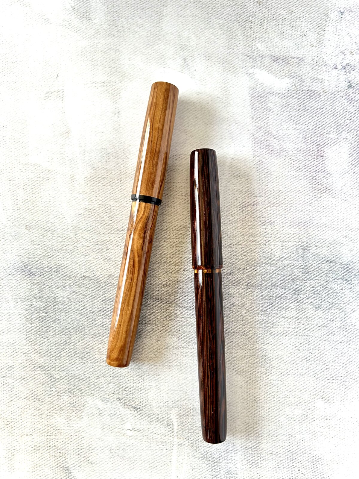

Growing up when something didn't go as planned my mama used to tell me "sometimes you're the windshield, and sometimes you're the bug."
Have you ever spent hours on something and been so proud of the results only to notice things aren't as perfect as you thought? We spent all weekend on these two pens only to discover in the end there are minor imperfections. So disappointing! I'm trying to realize this had nothing to do with our abilities, it's just one of those things, but it's just SO darn frustrating. (It appears that sanding dust is trapped within the finish.)
I don't think we talk enough about the ones that "got away." I think customers think every time we set out to make a pen that's it's a "win." That each one is a success, I'm not sure they realize that included in the price of each pen are the lessons we've learned along the way, the sections we were almost finished turning..only to get a catch, the fingers we glued together, the wood blank we sanded through, the threads that somehow came out wonky, the trial and error it takes to find the right finish. Hours and hours of on the job training, hours of frustration and failure, hours of honing our skills. Some days I am thoroughly frustrated with the journey and wonder what in the world I'm doing? Other days, I'm on top of the world and so proud of how far I've come.
I know sanding dust has nothing to do with my abilities, but the frustration level is SO real when you've put so much effort and heart into something, only for it to be unsellable. I mean it's not the first time, it happens more than anyone realizes, but I guess it's all part of the learning curve, and in the end it takes resilience to stick with something long enough to master it.
If it's any help I'm not seeing the dust in your photo. You do great work.

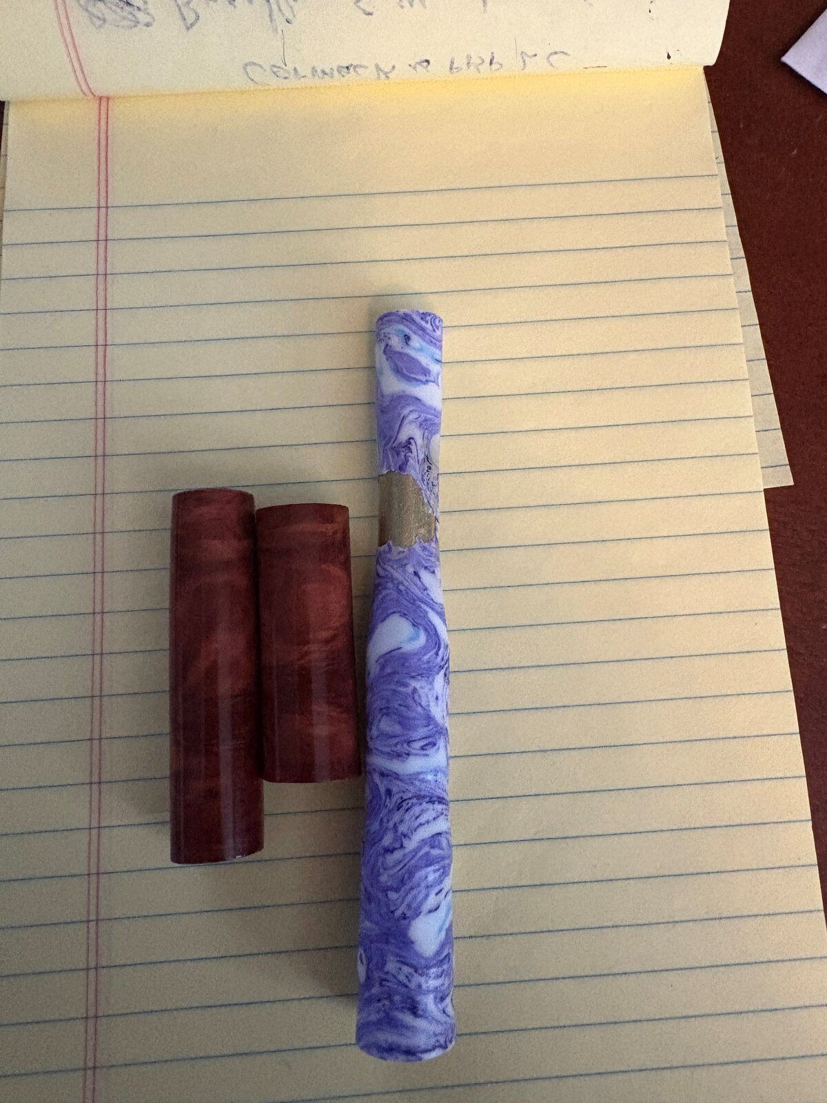

We all have issues. I keep these pieces on my desk to remind me to pay attention. The two pieces of mallee are from a time I couldn't figure out what was wrong with my disc sander and kept chasing "square". Turns out the machinist square I was using for machine setup had been knocked out of square and I didn't catch it. (literally and figuratively when it hit the floor) I wound up just using them as experiment pieces for finishing.
The other piece is a reminder to make sure I get good glue coverage or I'll ruin my niece's pen.
Honestly, they're good to fidget with while on conference calls sometimes too.

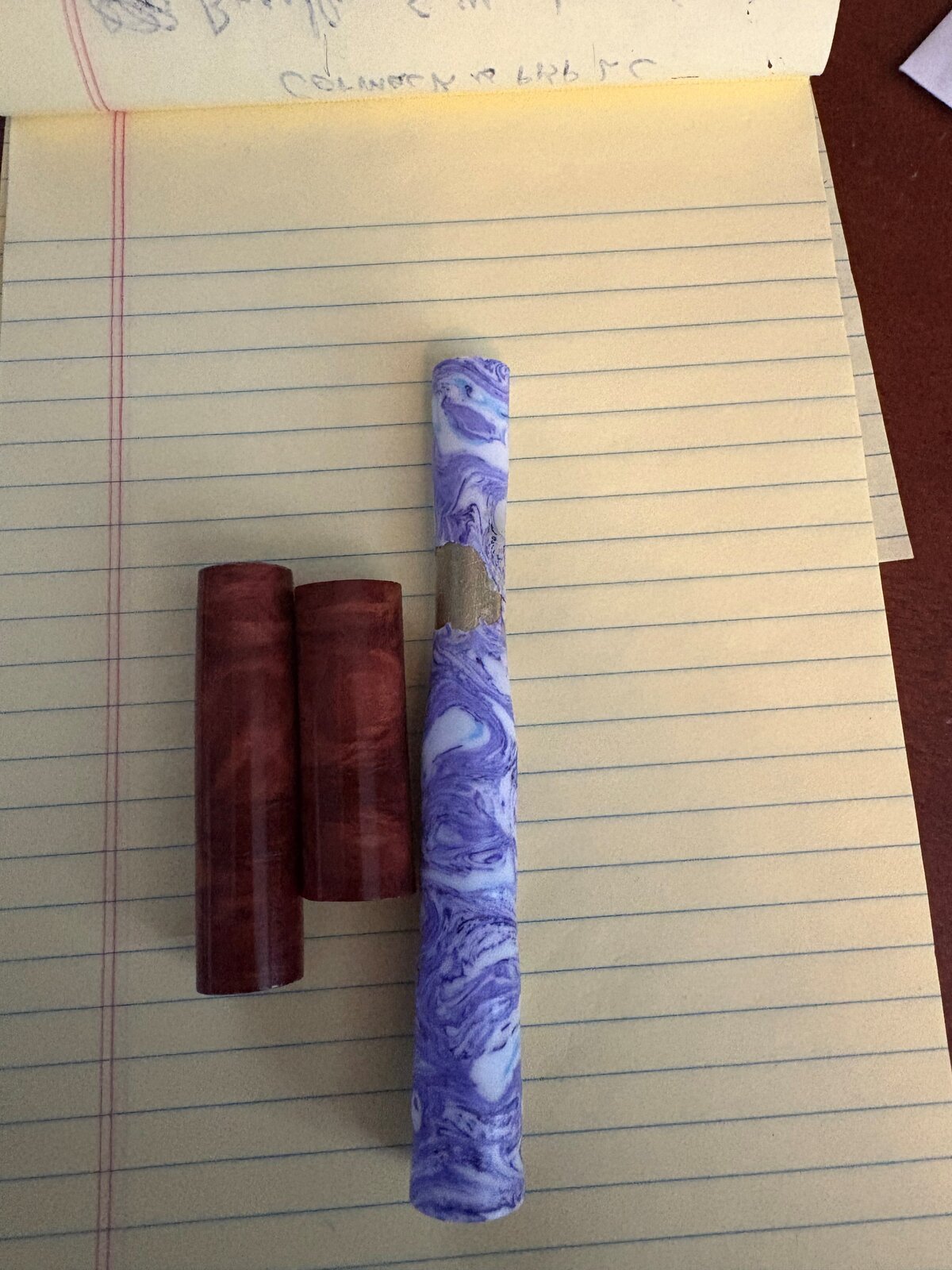

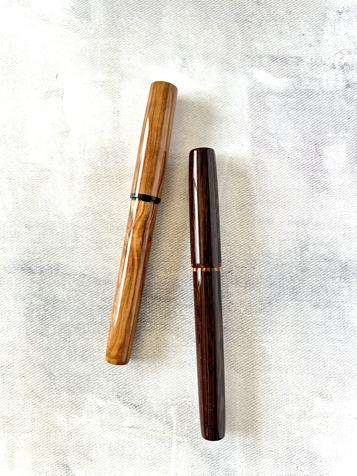

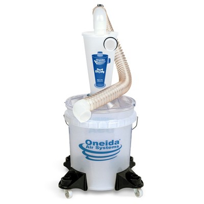

You can use a shop vac as a collection system. Two things you would want, are a small bucket-based vortex, which are not too expensive, and a decent collection hood for your pen work.
I bought this from Rockler years ago (mine does not have the deflector):
Then something like this:
In my case, I had to adapt the hose to my shop vac. I also used 2" flex hose throughout, rather than the small shop vac hose, which helps collect more dust overall. It won't collect everything, but with that rockler hood, you can kind of wrap it around your blanks while turning, and it will catch most.
Great idea! We always have such a mess and it of course is all over the garage. 🙄
2nd for the dust deputy deluxe! I bought one a couple years prior to buying my dust collector. They are awesome. Spend the extra for the deluxe kit because it comes with extra bucket, wheels and most importantly a short section of vacuum hose. At the time I was looking to purchase mine that cost more than the upgraded kit.
I went to the dust collector because I found a NIB jet collector for a song that is small and very quiet. It's probably similar to or smaller than the actual perimeter of my shop vac and dust deputy. The quiet part is what does it for me, my shop vac is so loud I felt like I needed ear muffs every time I used it. Dust collector might be fewer decibels than our household vacuum.
The dust deputy saved me a ton of money too because I kept Hepa filters on my dust collector so less stuff would escape back into the air through my old filter. I would clog them up at least a couple times a year. Once I put the dust deputy in front of the vacuum I'm not sure if a quarter cup of anything made it into the shop vac.
