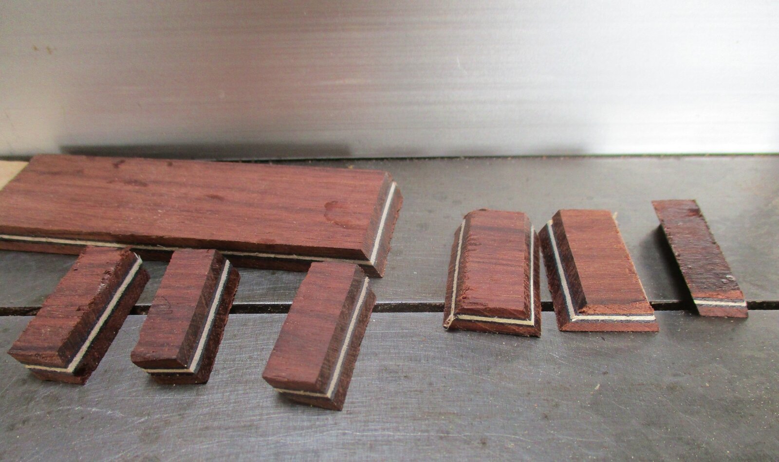

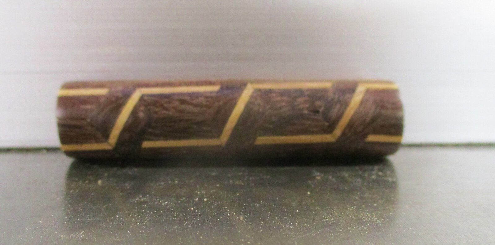

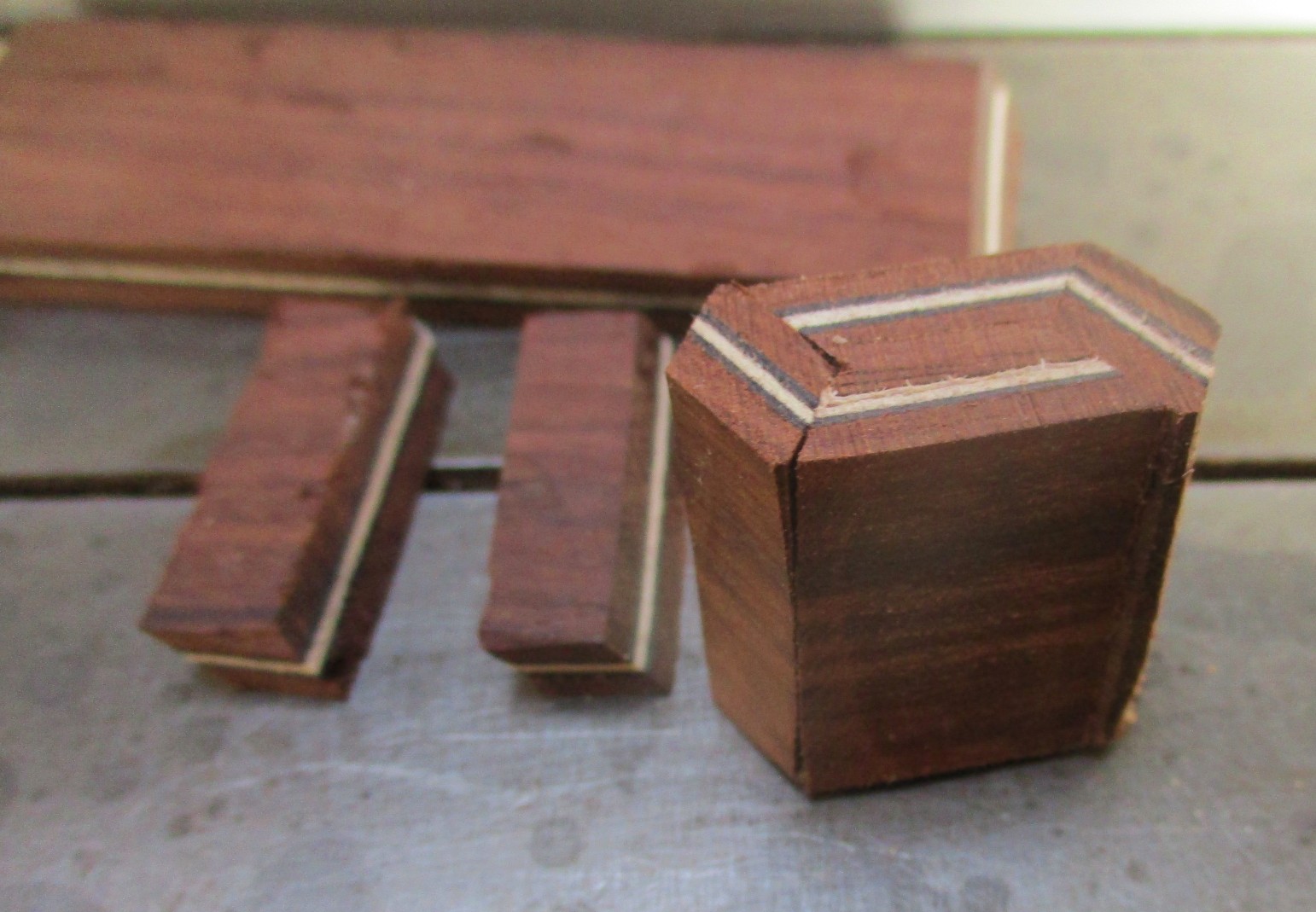

Alan Morrison Member Joined Jan 15, 2019 Messages 3,307 Location N Ireland Oct 30, 2022 #1 A few people asked how I constructed one particular blank which I showed recently, so for those interested here is the blank and a couple of photographs taken when constructing one similar.
