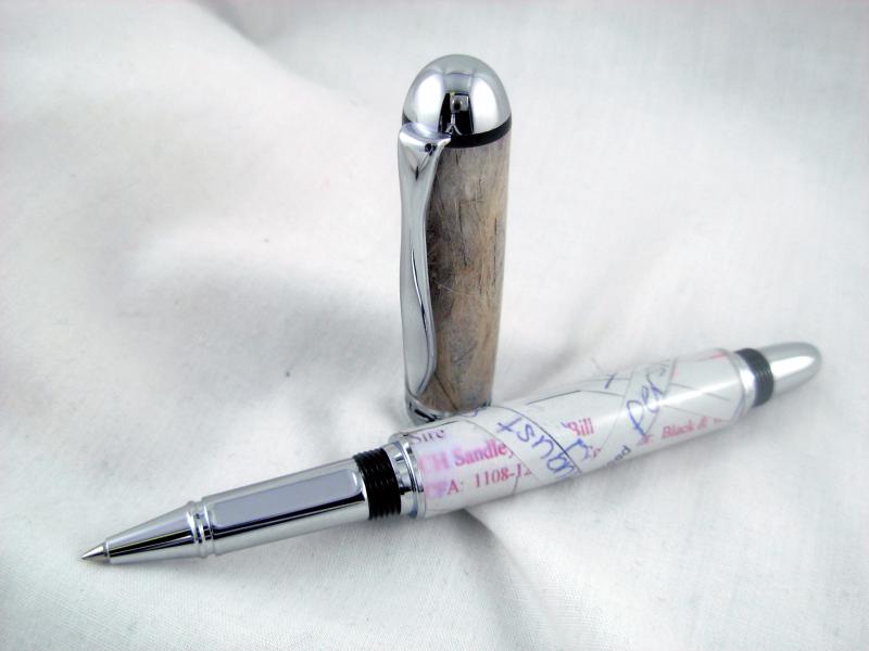

OK, I've done one of these as a request and I don't think I ever want to do another :smile:
I had a similar request and attempted a pen for the customer. The pen was to be made from the fur of three different cats. Different colours. When I wrapped the barrel and cast it, all the colours seemed to blended into one big "drowned rat" kind of look.
The customer loved it. I had a different opinion
The cap was fur, the lower barrel was done in a collage of the medical records.
Fur was glued to the tube and cast in clear resin
