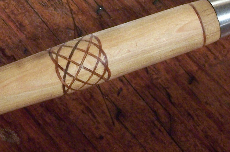

The way I approach it is to mill an approximately 125/128" square length of stock to an octagon by using a 45° chamfer bit in a router table. Then it's no different than making a 4 loop knot. Okay, maybe a little more anxiety is involved.
Example: 12th Bash Ballpoint Contest
I use a tablesaw with a 1/16" kerf circular saw blade. Make the knot material as thin as you can, but just a bit thicker than the kerf the blade makes. Then use a whisper thin spacer to increase the size of the kerf to fit the knot material thickness.

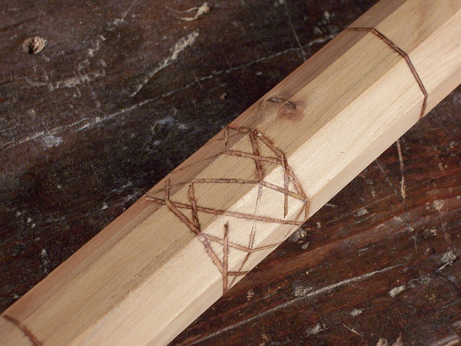

Making a thick pen with a steep angle also helps. Too thin or too shallow and its a Celtic lump. :)
You may cut an octagon, then cut without going through, stop a wee before having two pieces, this way the knot will stay in alignment.
