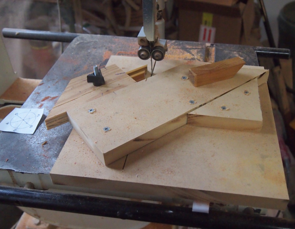

I am not sure who Grant is but I appreciate his article. I then made a sliding jig for my bandsaw.

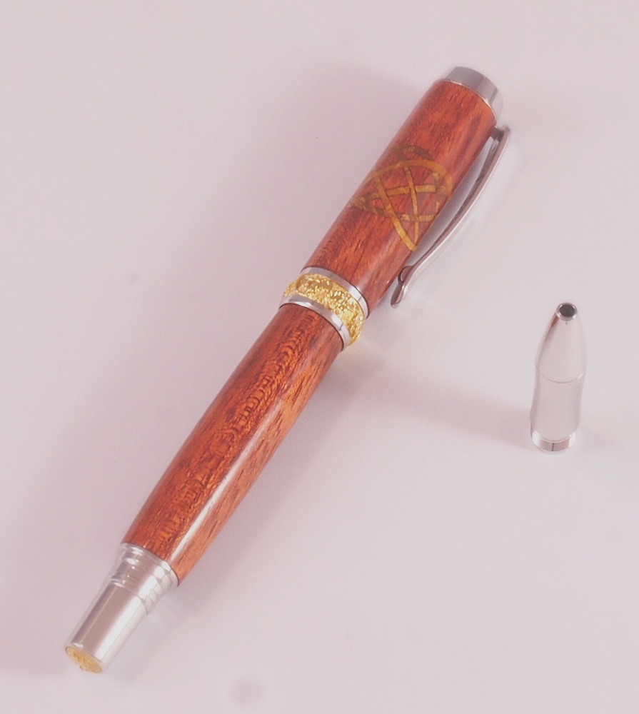

I then spent some time how to made a six strand Celtic knot. The gluing was the most challenging part for me. I could not figure out a good approach for clamping and finally resorted to using CA and holding together by hand. I need to come up with a better approach in order to add metal inserts or multi-color segments. Hopefully BrainG will share some tips. Here is the result was of my efforts.

Cody,
Don't cut all the way through the blank. This will maintain the alignment and stop the slipping and sliding. Of course this will require your knot insert material to be the same or a slight bit thinner material then your saw width.
Since you did six sides did you start with a round blank instead of a square one?

Just saw the pie chart on your cutting jig so I presume it was round.

I did not cut all the way through and had some issues with the inserts not being deep enough. So I started cutting deeper and all was good until the 5th and 6th cuts when it was getting more and more unstable. I did use a round blank.
