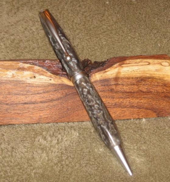

The pics show it mixed with copper Pearl-ex and silver Pearl-ex. Looks okay to me but not what you would get with clear resin.
I believe I also tried using Alumilite dyes but that didn't come out so well and I didn't get any pictures. I believe this was more operator error than materials issues.:eek:

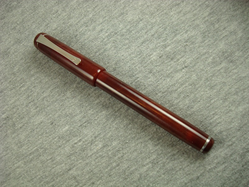

This was done with 3M fiberglass resin using acrylic paint for coloring.
Coffee bean blank on a chrome slimline stylus.
Finish is CA to seal in the coffee beans.

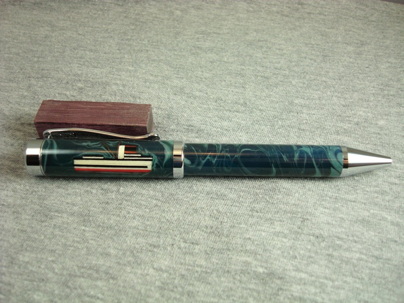

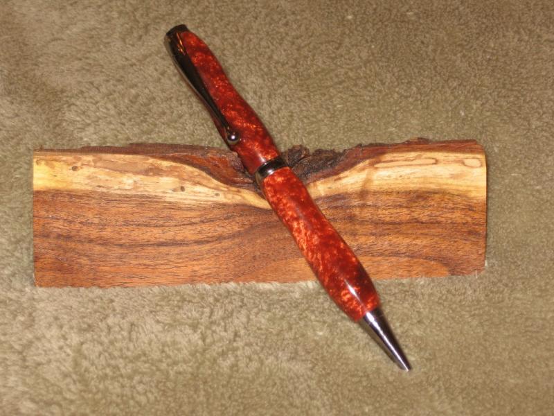

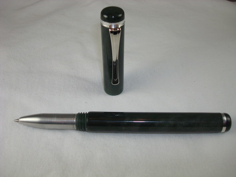

Just saw this thread. These 3 pens are made with fiberglass resin. I used a little less MEKP than they said to and they turned just fine. The resin is amber toned and when you mix color in it you will get whatever color amber and what you add is. The pen with the ship in it was colored with blue model paint. The smell is quite strong. When you buy the resin there is some catalyst under the plastic lid.

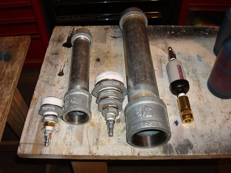

I did the red one by just putting it on the tablesaw with the blade down and letting it run for about 5 min. There was still bubbles, small ones that became visible because the dust from finishing went in the holes and showed white. I let the dust dry, blew out the holes with an air compressor and filled with CA. Then I built a small pressure pot out of galvanized pipe, my air compressor has a regulator on it so I didn't have to but one. I just leave the whole thing hooked up so if there is a leak the compressor will turn back on.
This is my pressure pot. The grey thing is an inline water filter. When I use it I can only pressurize to a max of 90 lbs. because that is the max of the filter. I just clamp it to either the side or top of the table depending on what way I want to cast. I can put 3, 3/4 " pvc pipe molds in the large one or a 12" long mold made from a cutting board for a 7/8" square blank. I don't use the water filter when casting with PR or fiberglass resin.
Very interesting pressure pot setup. I tried the "bandsaw vibration" thing and didn't notice much difference. I setup my HF pot last night and have already poured a couple of blanks. Pressured them to 50 psi and when I cut them to length I cannot see the bubbles I could previously see just cutting the blanks. Once I finish the current pen I'll be trying one of these out.
