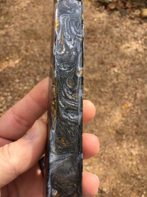

First attempt at a 3 color blank. Came out pretty good. There is more gold on the inside than seen on the top. Can't wait to turn this one
You have committed to a photo. I would guess a casting is like wood- the final product is different than what you started with.
"Life is like a box of chocolates. You never know what you are going to get."- Forrest Gump
Thanks for all the good responses!
Alumilite clear resin. Colors: gold was pearlex gold powder no dye, silver was alumilite powder no dye, gunmetal color was black alumilite dye with silver alumilite powder.
Very nice! Isn't it great turning a self cast blank and seeing what's hidden inside? I still get excited with each one, and probably always will.
It's pretty crazy seeing what you thought would be horrible ends up looking awesome and what you thought would be awesome looks "meh"
