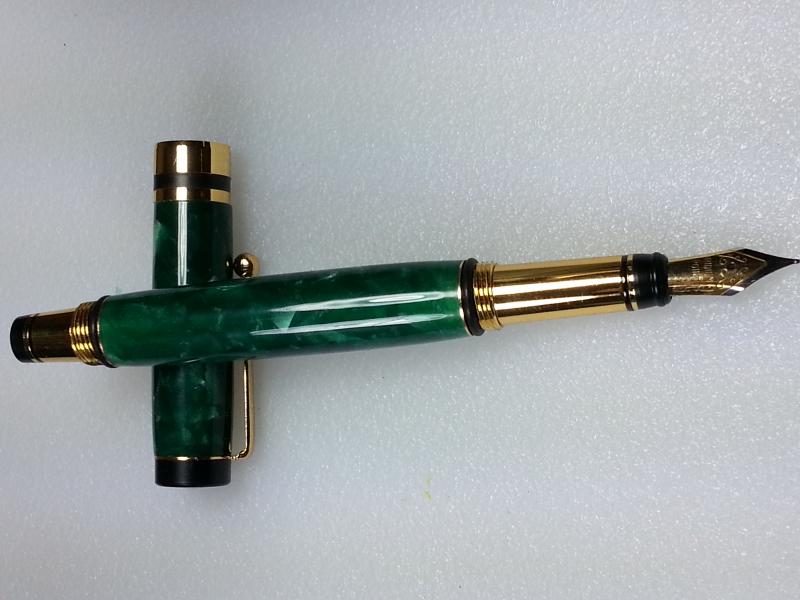

This is my second fountain pen I've made. I have a couple of questions about them, How do you tell nib size, how do you clean them and what do you use to clean them with?

Well the most common sizes found in pen kits are 5mm and 6mm - typically the nib size is governed by the size of the pen larger pens like full size Gents, Chairman, Emperor and many others will have a larger nib. The many varieties of small pens (jr Gents, Majestic Jr, Classics etc) seem to have nib size in common and it's 5mm.
You measure the nib at it's widest point to determine the size. After you see the two most common sizes side by side, you look at the nib and you'll know.
Cleaning I'll leave to others.
If your asking the nib size as to writing tip most of the kit or component nibs are what I would call a heavy medium, if your referring to the physical size as Smitty said there are two sizes that come with our component sets 5 MM and 6MM to tell which size your component sets have 5mm or 6mm measure the width of the feed , they will measure 5MM at the widest on the smallest fountain pen components and 6MM on the larger component sets. Cleaning is pretty straight forward,
As I said it's not rocket science to clean, go to the infant dept. at your local Wal-Mart and purchase a nasal syringe, fill a small bowl with tepid water, have an empty small bowl next to the one with the water. Run water (tepid water) over your feed and nib from the back side until it runs fairly clean , sorry I should have told you first to remove the section and take the cartridge or pump of first, Now fill your syringe with the tepid water and place it on the back side of the feed where the cartridge or pump attach and flush the feed into the empty bowl, you'll see ink still coming out do this as many times until it runs clean. You now have a clean feed,nib and housing.

btw ... that pen looks great, emerald green has always been my favorite color for a pen
