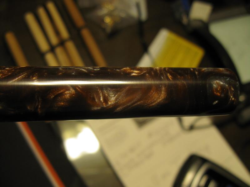

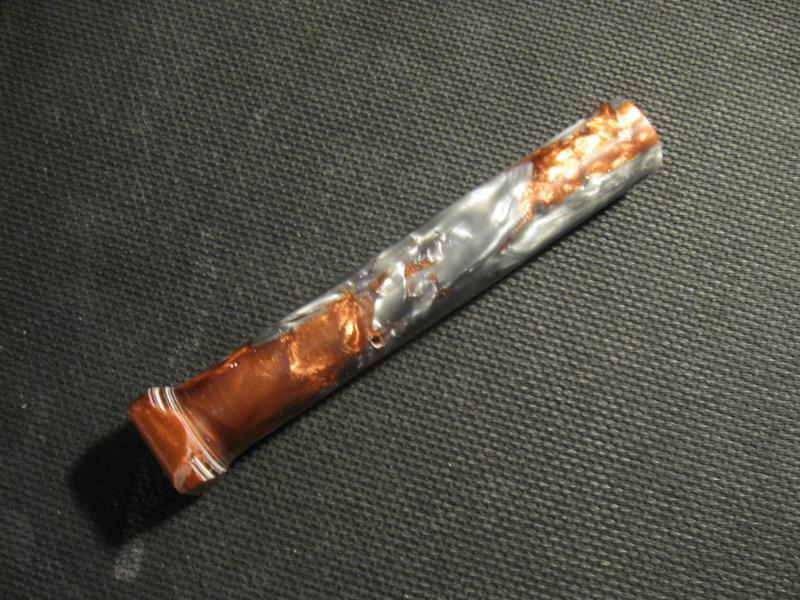

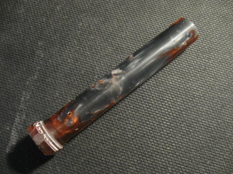

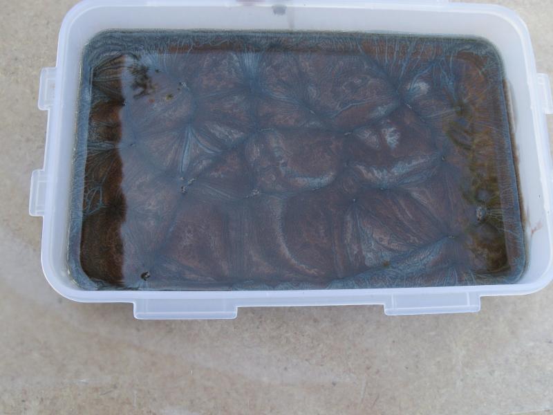

Ok it seems that 1 minute makes a ton of difference in a multi-color pour. The first was a Copper & Silver pour and the sliver as I was pouring it went to a jell state (really thick) and the copper was a little better somehow they mixed but I do have air bubbles which you all told me but lesson learned. I turned one round to see what it would look like and you can see the bubbles maybe I can fill them but the blank is nice looking.

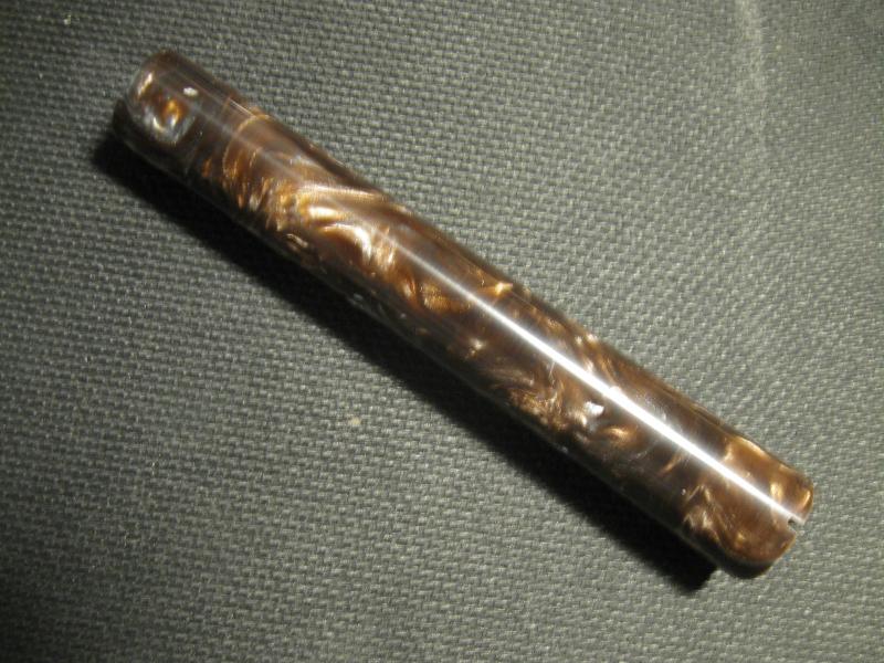

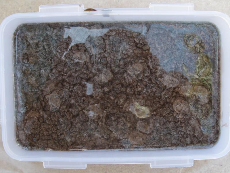

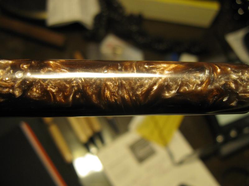

Number 2 pour was an Antique Bronze & Silver and the pictures show the setting process for me. from just poured plus 10 minutes to 20 minutes where it stopped changing,
The blanks I cut and had to round one to see what it looks like and I love the colors and how this came out I was in a little hurry and do have some chips but when the pen is done I think it will be nice. Anyways let me know what you think. I used the Jaqurd Powders in all of these.

Thanks as for the MEKP I used 5 drops per ounce. The second bronze and silver looks like a root beer float coloring. The only thing I don't like about castin craft is, that it is kind chippy so I am going to try another local one.

I'm going to put a +1 for going with Silmar. It's not much more, maybe $50 shipped, and when it comes to advice or tips/tricks you won't have the problem of "will my resin react the same way?". With my many learning experiences a couple things I can add are when it comes to color separation timing is everything and you've hit both sides of the spectrum. With the first blank I'd pour a bit earlier bc what I've experienced is once 1 color has started to gel it has it's own "elasticity (sp?)" so to speak. It's hard for me to put it in words but take your first blank for example. The silver and copper are a bit more separated than swirled. Thats because either both or one color tried and succeded to pull itself back together after swirling them. It was just past that sweet spot of the gel timing. The second blank is a hair too quick and thats why you had more swirling than separation. That's also why you had air bubbles with one and not the other bc there was room for them to rise and not get trapped in the second casting. Please don't think I'm being judgemental. There's nothing wrong with either blank, I think they're both beautiful, but my hope is to help clear thinkgs up and show why the pictures of the curing in the mold process changed so drastically in such a short time. Also, if your timing is way off, or a million other reasons like: too much pigment in 1 color, not enough catalyst in 1 color, or you weren't wearing a blue sock on your left foot, one of the two colors will sink to the bottom bc (and this is my assumption) as it cures and solidifies it sinks and you'll have what I call a 50/50 blank and depending on how bad they look it'll go in my "undesirables" box. I think you're well on your way to creating more awesome blanks and I wish you the best!
Thanks Brooks after the first pour which at 9 minutes is when the silver started the gel stuff and at 7 minutes on the other so I am going to try 8 minutes next time and watch carefully. I think as long as I keep the MEKP the same it should be ok but you never know the bronze and silver kind of reminded me of a root beer float which made me want lol. Anyways thanks for all the help. Onward and upward learning as I go.

As for gel time Jerry, it depends a lot on temp. If I'm using the heater in my ultrasonic it can be under 5 min with 3-4 drops. Leave it at room temp and it can be 20 min. For swirling I prefer a slower gel time - it takes longer, but the window where it's thick enough but not too thick doesn't close as fast.
I really have to agree with Jason. I don't preheat my resin bc I want that open gel time to do my thing. Yes it takes 20min or more but you can use that time to start mixing another batch of blanks. Still check your catalyzed resin frequently to ensure you don't miss your window. Plus the longer gel time gives the air bubbles more time to escape and since the catalyst creates heat it will help with air as well. You'll find the method that works best for you.
