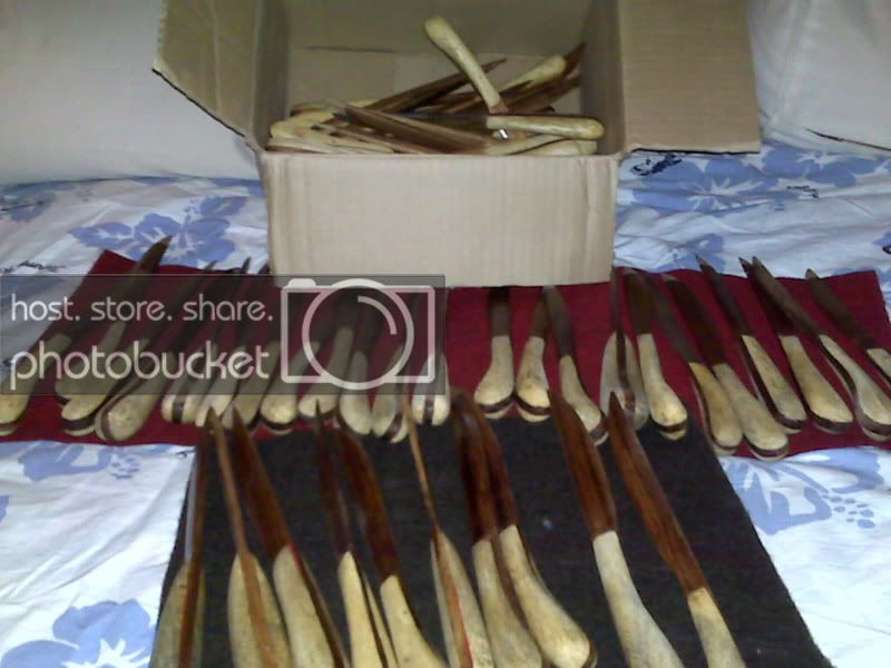

My question tho is do you make your wooden letter openers from scratch or is there a kit out there that you use? Those are great.
Didn't want to hijack your thread, just curious on the openers and share what works for me after many failed methods that I tried.
