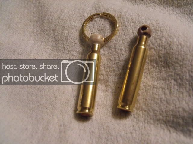

I was in the shop this afternoon and decided to try an idea i had in mind to make a key chain out of some 223 casings. They are a little small for pens for me. So i decided to make the end for the key ring out of some antler and turn a tenon that would glue in the neck of the casing. I was pleased with the way they came out. I plan to make more. Hope you enjoy. Thanks, Keith

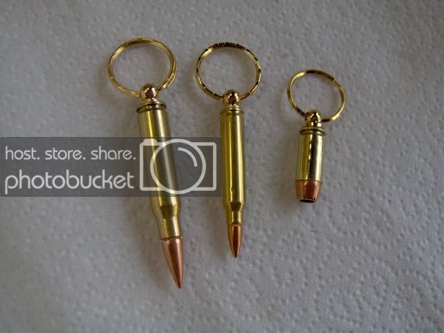

I do mine a little different because I think it looks more like a bullet if the key ring is in the back of the shell. I happen to use real bullets only because I have them for my cartridge pens.
Maybe you could turn a wood bullet if you do not want to get the real thing. Just a thought but thanks for showing. By the way here is a poor photo of mine. I do need to take a better picture but you get the point.

Thanks for the kind words. I get my kits for those here. http://www.leevalley.com/wood/page.aspx?c=1&p=32826&cat=1,330,43243,50237&ap=1
I like these alot better than some of the cheaper ones because the key ring swivels. Just feels more confortable to me.
Sorry Pat I did not see the other part of your question. These kits are a regular kit with a tube like used on pens. I drill the casing and solder my tubes in and the ring body just press in. I also powdercoat my casings clear. Keeps from tarnishing. As you see I also use real bullets. Have a great day.
