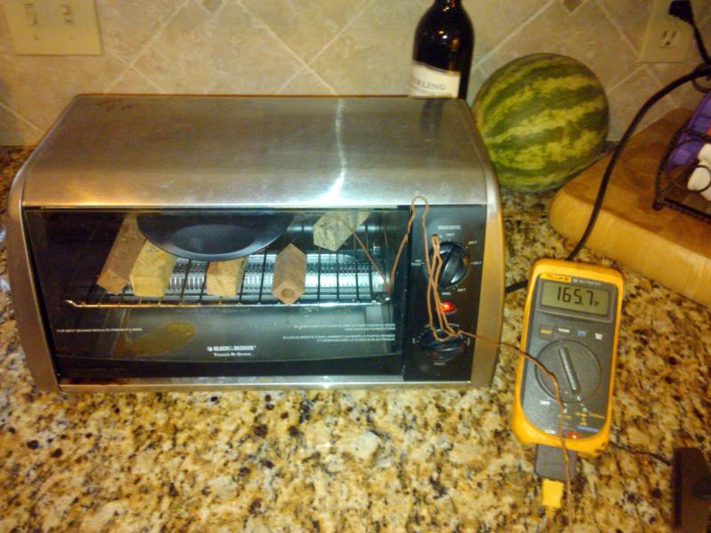

Here I cooked my test blanks for about 2 hours at a low temp to make sure all moisture was gone, then I let them cool for 2 hours.

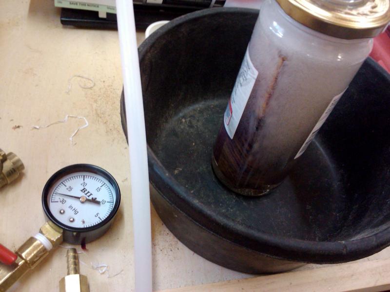

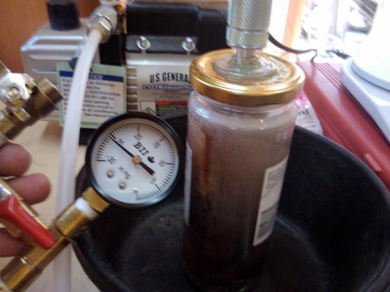

I have an olive jar that I was using for testing purpouses. I had to stay close because the juice would get in the lines and I had to Repeatedly remove the vacuum and clear them out. Here you can see it is at 25.5 and starting to calm down. I literally had to bump the vacuum up by .5 each time becasue it would go crazy.
Here it is at 28 and you can see it is going crazy again. I made it to 28.5 and held it there for 1.5 hours.
When all was said and Done I removed and wrapped the blanks in foil like Curtis in his Video. You may notice in the 1st pic I am using the Temp Feature on my Fluke MultiMeter. This is great because I can identify ranges. I found a spot on my Toaster oven that ranges from 185 to 209 degrees.

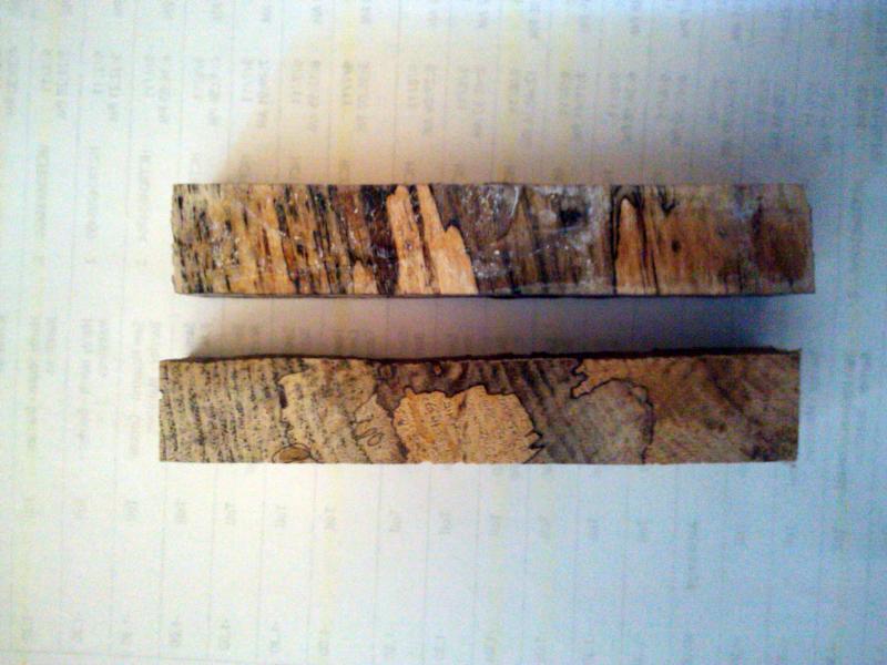

I ended up doing 1 Piece of Hickory and 2 Pieces of Redwood Burl. I knew the Redwood would fail but had to try. The hickory on the other hand went from 34 grams to 68 grams. Amazing!! Before I could pick it apart w/ my thumb nail, now I can't even dent it with my nail.
Piece on top is stabilized and bottom off the same chunk not. The difference is more odvious than my camera phone will pick up.
