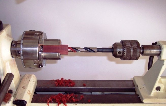

Bart....This is how I drill some of the larger holes on my lathe. I use this method when accuracy is of importance. Hope it helps.
<b>Image Insert:</b><br />
<br />
When drilling some of my laminated blanks it is necessary to stay as close to center as I can.This is also true when I want natural bark on deer antler.
In those cases I will turn between centers to 3/4" and using the 3/4 Beall collet chuckon the drive end and the jacobs chuck in the tails stock, drill on the lathe.
I can also drill a more acraute hole as in single body pens longer 4+ inches with this method.
It takes longer ,the collets and chuck is fairly expensive but the results are more repeatable.
