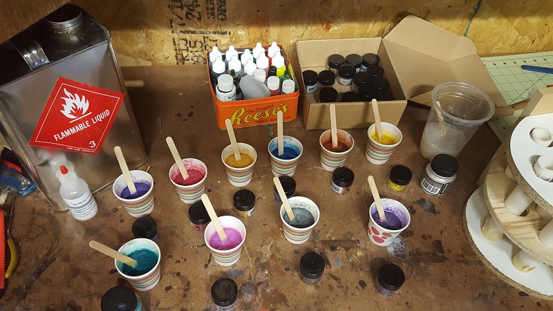

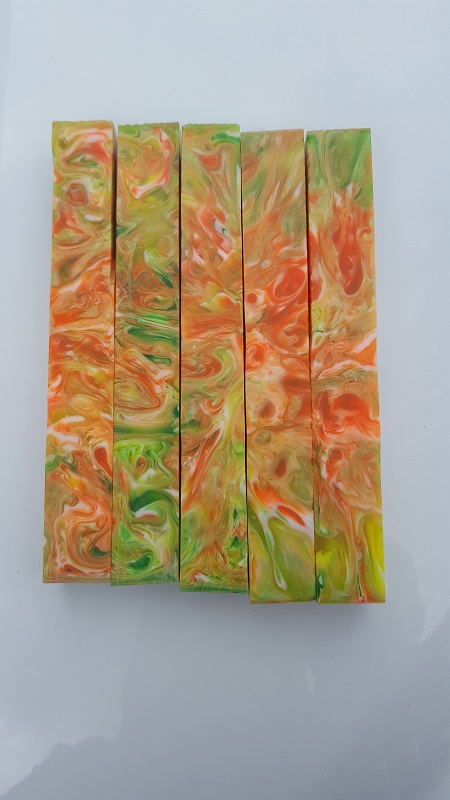

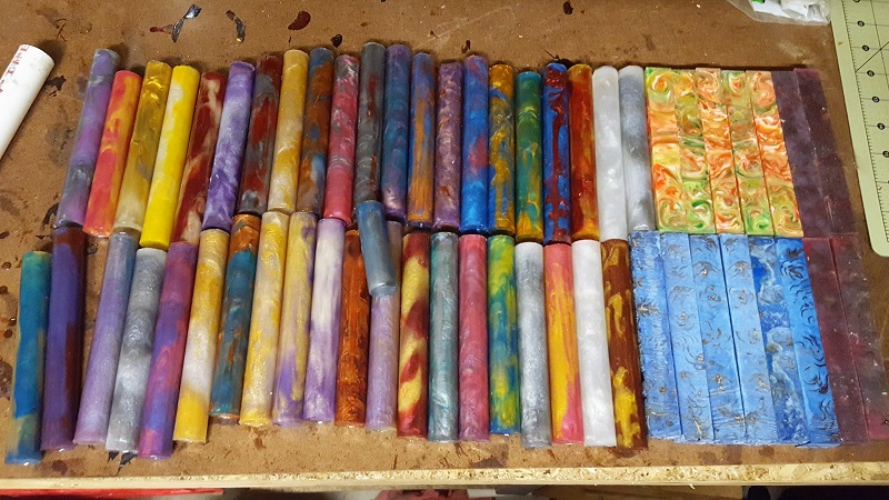

I spent a few days last week consuming a gallon of Silmar 41 that I've had for too long. I figured I better get it consumed before it got too cold for me to cast in Ohio.
Most of them were done in 3/4 PVC with PearlEx powders. There is one "1/2" blank because I forgot to tape up the bottom of one of the tubes so it leaked out :)
The ones on the right are Stabilized Pinecones, and a 4 mix of the Fluorescent Alumilite Dyes.
Fun stuff, still have 1 gallon to go!

I stick with three things for coloring my blanks, which you can actually see in photo 3.
1) PearlEx Powders: These can work in Polyester Resin and Alumilite
2) Alumilite Dyes: These can work in Polyester Resin and Alumilite
3) Casting Craft Color Pigments: These CAN NOT be used with Alumilte. (Water based, and water + Alumilite = bad casts)
I have the best/most consistent results with PearlEx powders.
