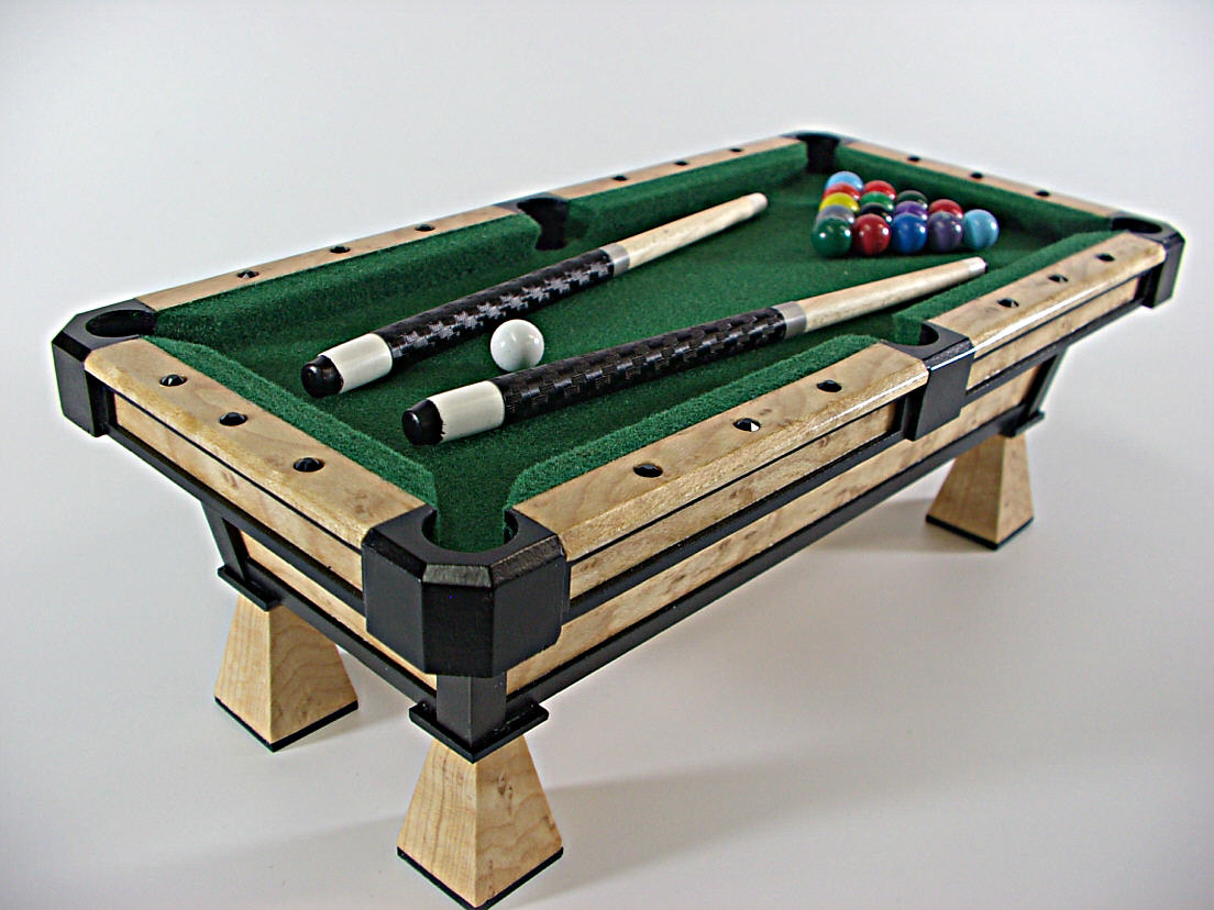

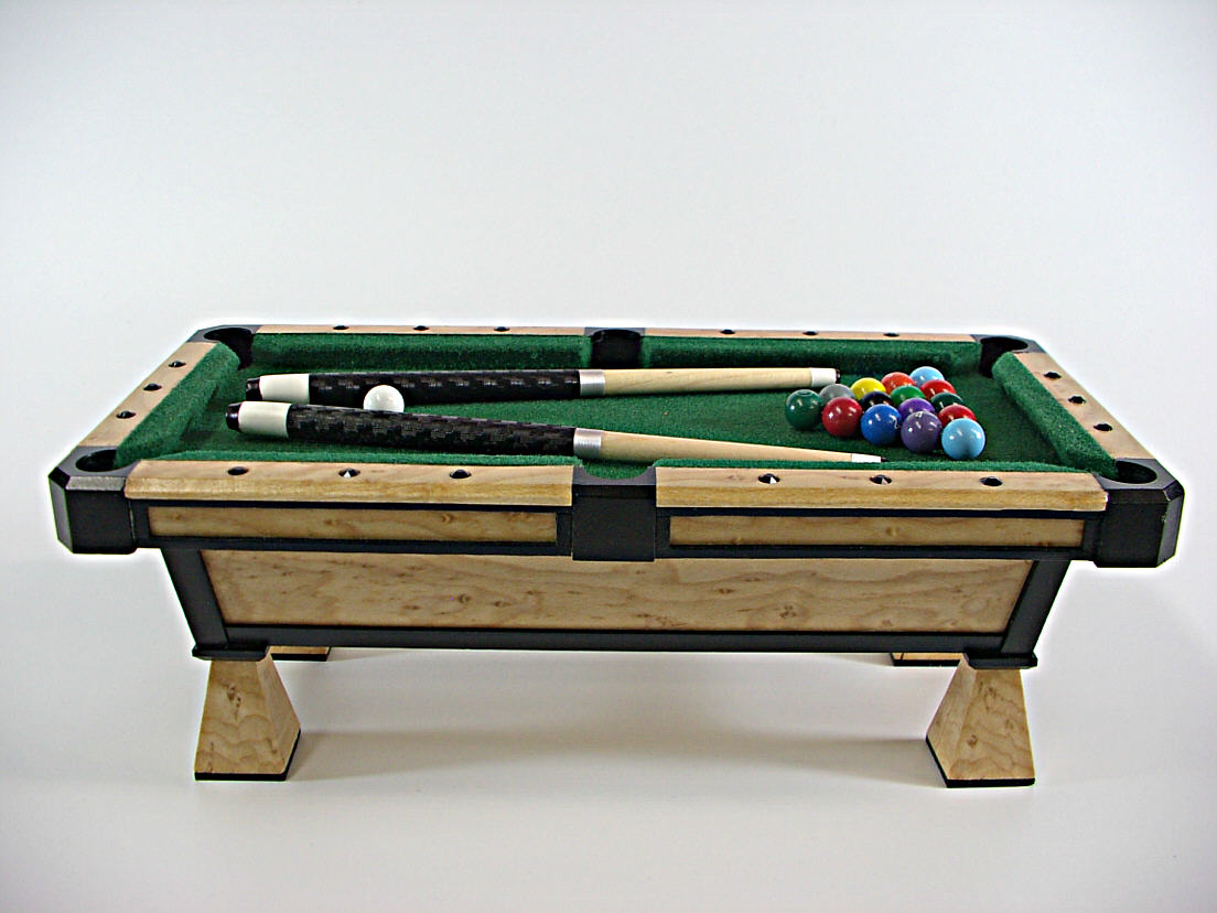

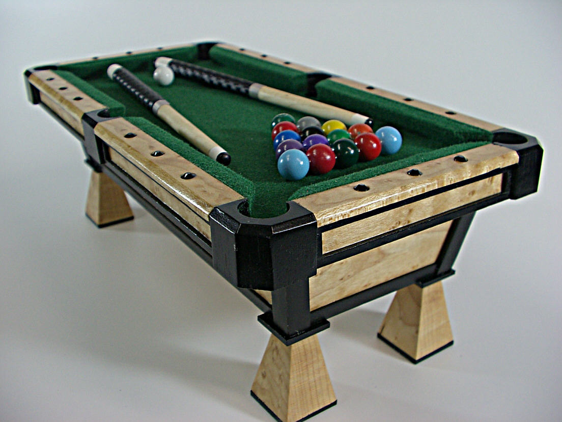

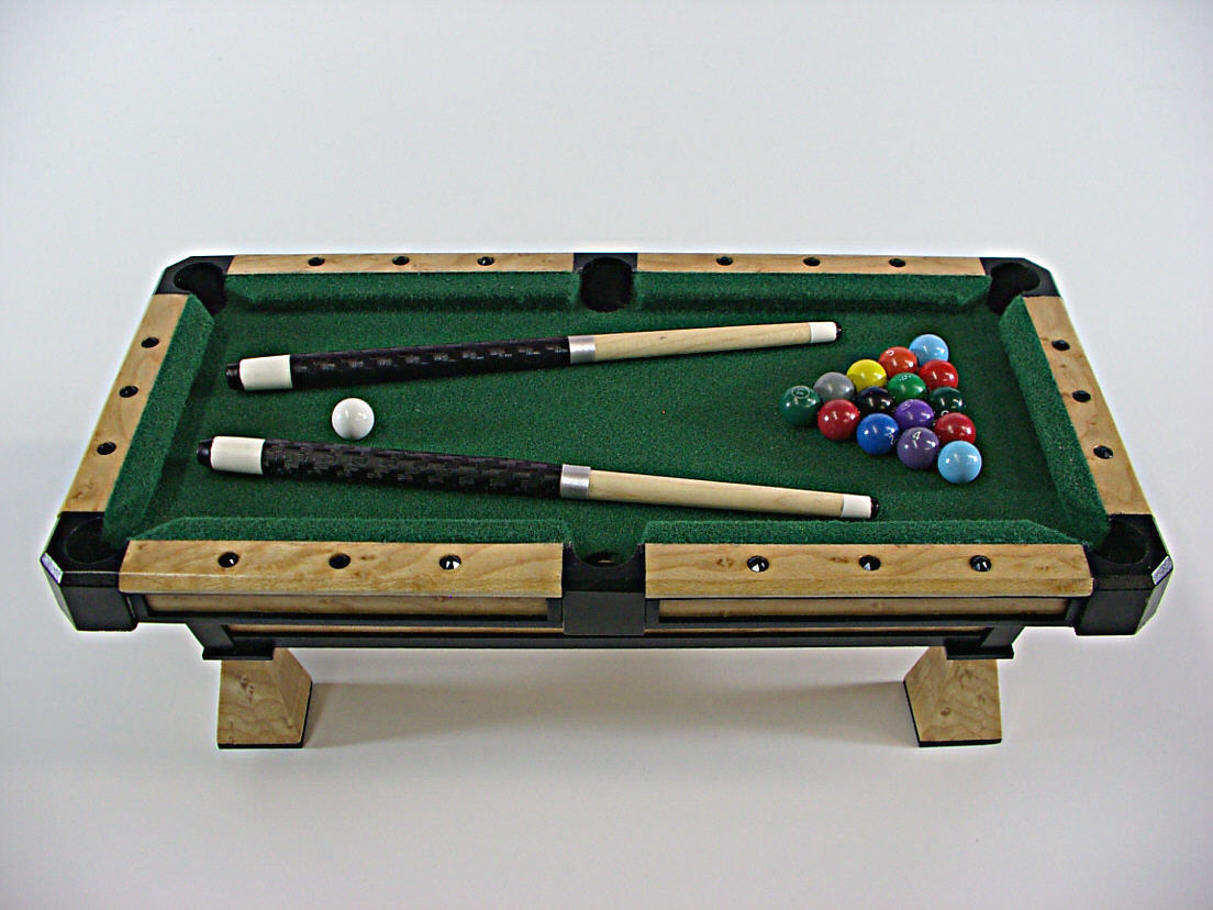

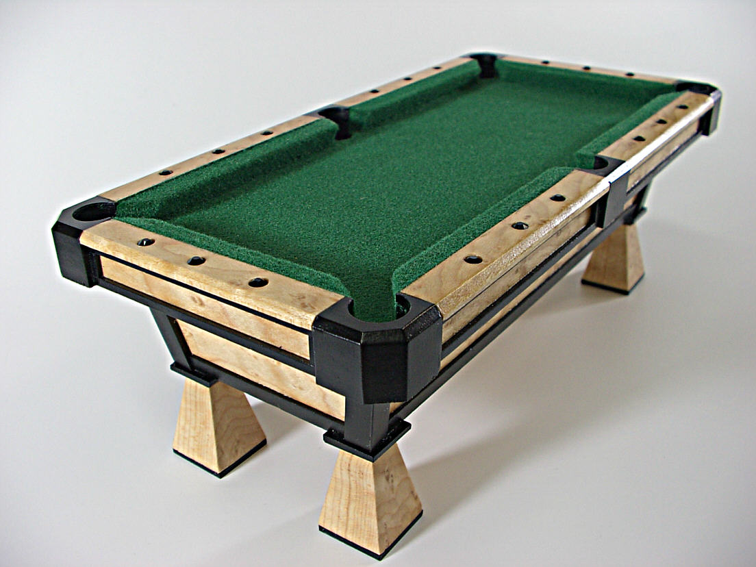

My replica pool table box is made from Birdseye Maple and Gabon Ebony. It's measurements are 4-1/2" X 9" which is a scaled down version of a professional table. It was dipped in BLO and then top coated with 6 coats of satin lacquer. The table top has green flocking on the table as well as the bumpers.
The cues were turned from maple blanks and are also satin lacquered. The butt grips are wrapped with carbon fiber. The billiard balls are miniature replicas. The rail sites are round black Swarovski crystals.
All the materials used were cut and angled using various jigs. The table is an easy lift off to access the pen box compartment which has a green plush felt cushion for any size pen. The lid has guide blocks to properly seat it easily on the box.
This is a neat little box which will enhance that special pen for that special billiard fan.
Happily it took first place.
