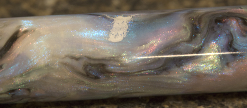

I wanted to experiment with applying a CA finish to one of my resin only pens, to see how it would affect the polish.
I applied 4 coats of Mercury medium flex, using a small piece of craft foam. applied accelerator between coats, and wiped the blank off with a blue shop towel. After 2 coats, wet sanded with 600 to get rid of some of the roughness, then wet sanded again after the final coat.
Assembled the pen, everything looked fine. Come back about an hour later, and this.
As far as I can tell, it's not on the surface layer. Won't scratch off, and the light reflects off that spot like any others. Anyone with more CA knowledge who can give me a hint what I did wrong?

Did you make sure there were no oils from your hands on the surface, wipe down with denatured alcohol or anything? Sounds like separation from your material, or moisture getting trapped within layers possibly.

Did not do either. Just seemed weird, because I've never had it happen when applying CA to wood.

Interesting. to me it almost looks like some of the whitish CA residue left behind on my wet sanding pads that shows up after the water dries off. Did you wait a while between wet sanding and applying your final coat of CA? - Dave

Did not, though I thought that I had thoroughly wiped it off with a clean shop towel. Hmm.
A part of me wonders if it's worth doing the CA finish on a pure resin pen.
