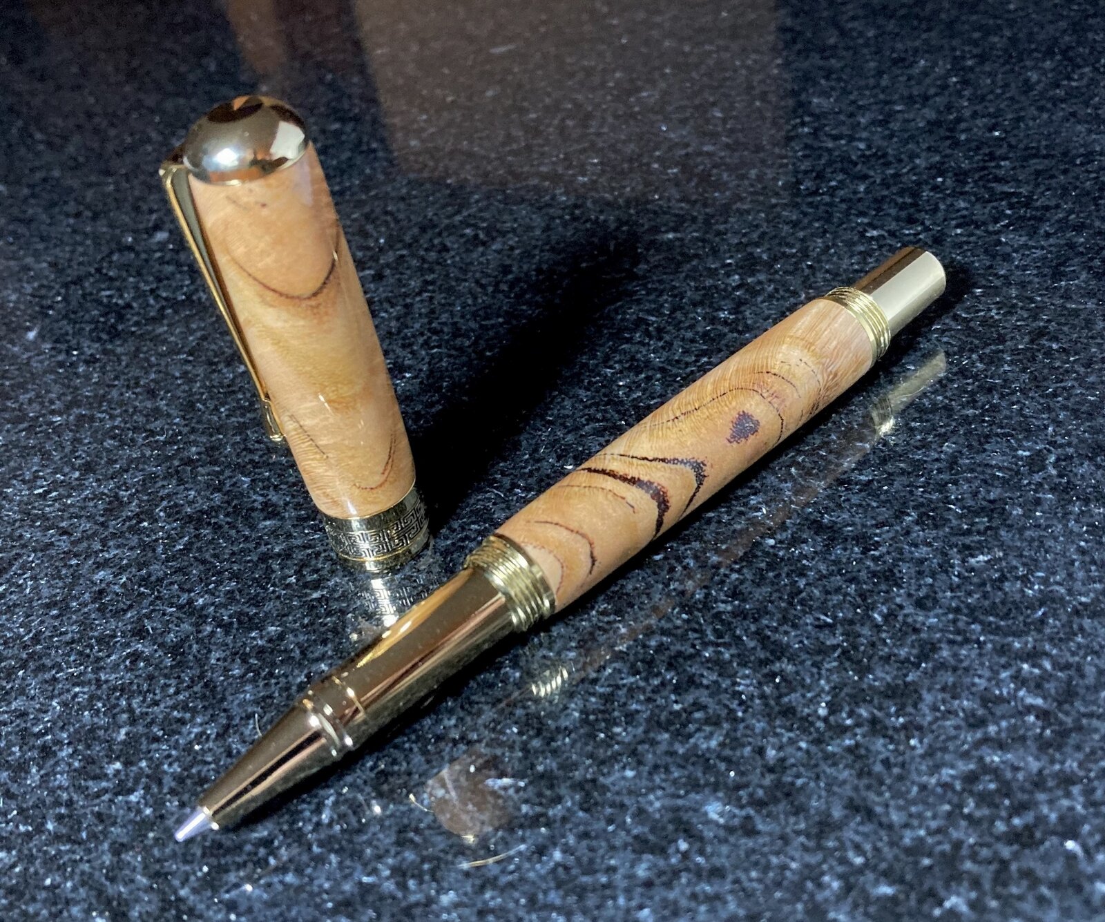

I have made two more New Series pens successfully using your suggestion. It's now a 3 part process. Turn on the mandrel with bushings down to approximate size. TBC with bushings to exact size. Then lastly I TBC without bushings another .005-.010" because the CA finish brings it back up. I don't use sandpaper for anything. The last scrapes with a skew come off like dust and leave no tool lines.
