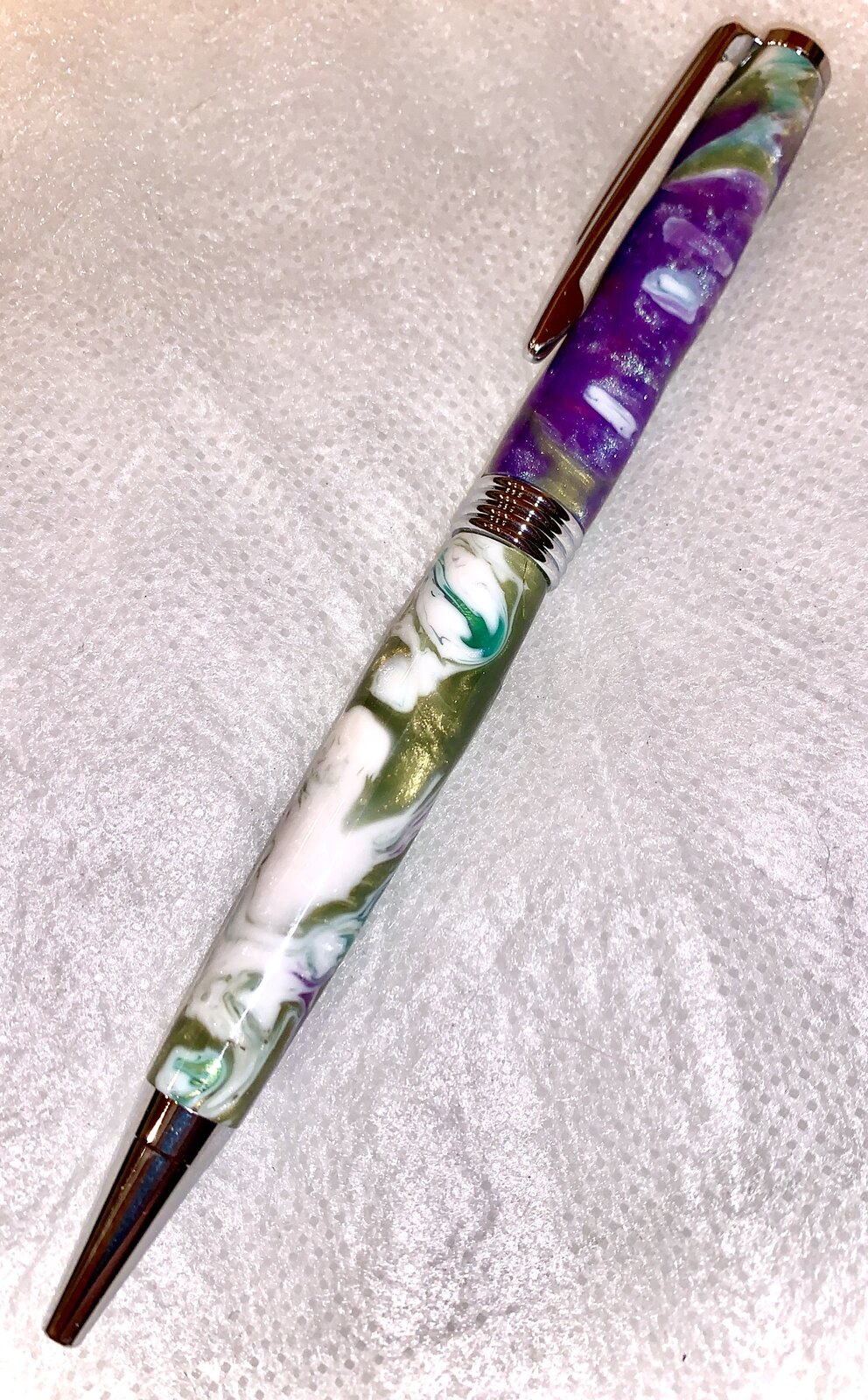

Hi folks, one of my wife's slimline pens needs a new refill, and I can't get it apart. I don't want to resort to heavy handed methods which will likely break it. Any ideas?

Slimlines just pull apart - the upper portion of the body is a friction fit to the transmission. Why is your pen stuck?
First thing that comes to mind is to put on rubber gloves to get a better grip on the upper and lower parts of the pen.

Is it a one piece slimline.
no, a 2 piece.

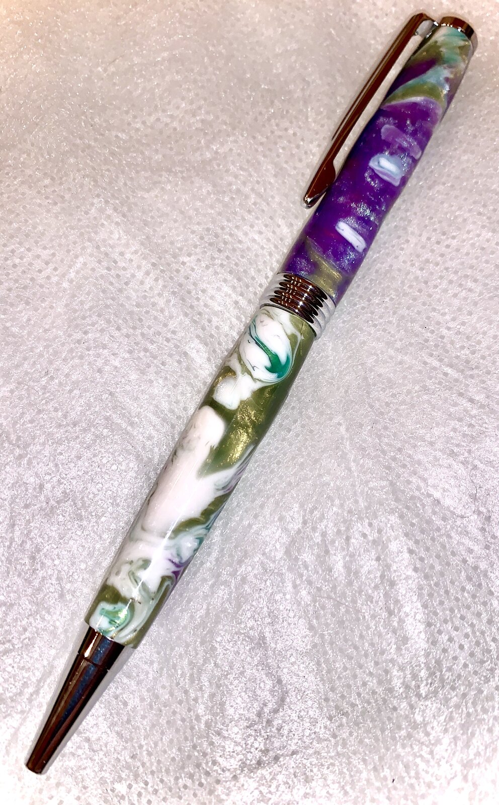

Rickhogan
Feb 26, 2023
4
Central New York
Looks like a small crack just below the trim ring. If the aforementioned "someone" put CA in that crack, it might have glued the lower piece to the transmission, which is going to be a mess to get apart.
