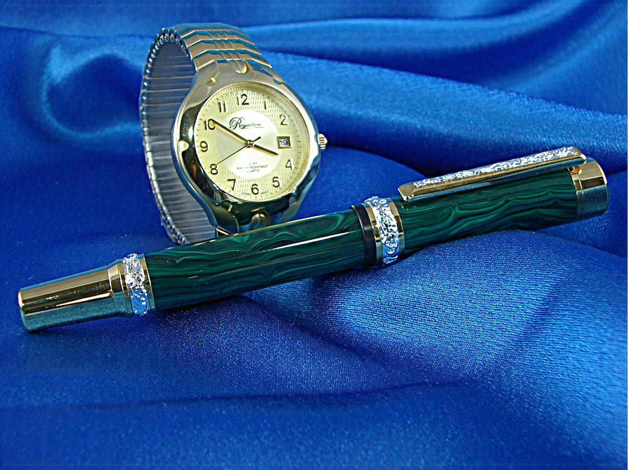

Speaking of green, here is a photo when I was using blue as the cloth behind the shot and again no tent. Now you get into colors they absorb light more so so you need more light. But you get the point. Many of those tents come with various colored felt pads that you can use. I am not a fan of tents any more. At one time I got into taking photos outdoors but that got to be a pain because you need to get the sun just right. I had a blue board that I would set up and did many of my scrollsawn items with that. I never could get the mirror thing going right but would like to try that again at some time. I wish I knew a pro photographer that could show me how to take real good photos. That is the key to nice photos. Knowing light angles and using props properly.

John:
What are you using for a camera? All I have is my iPhone & it lacks depth of field.
