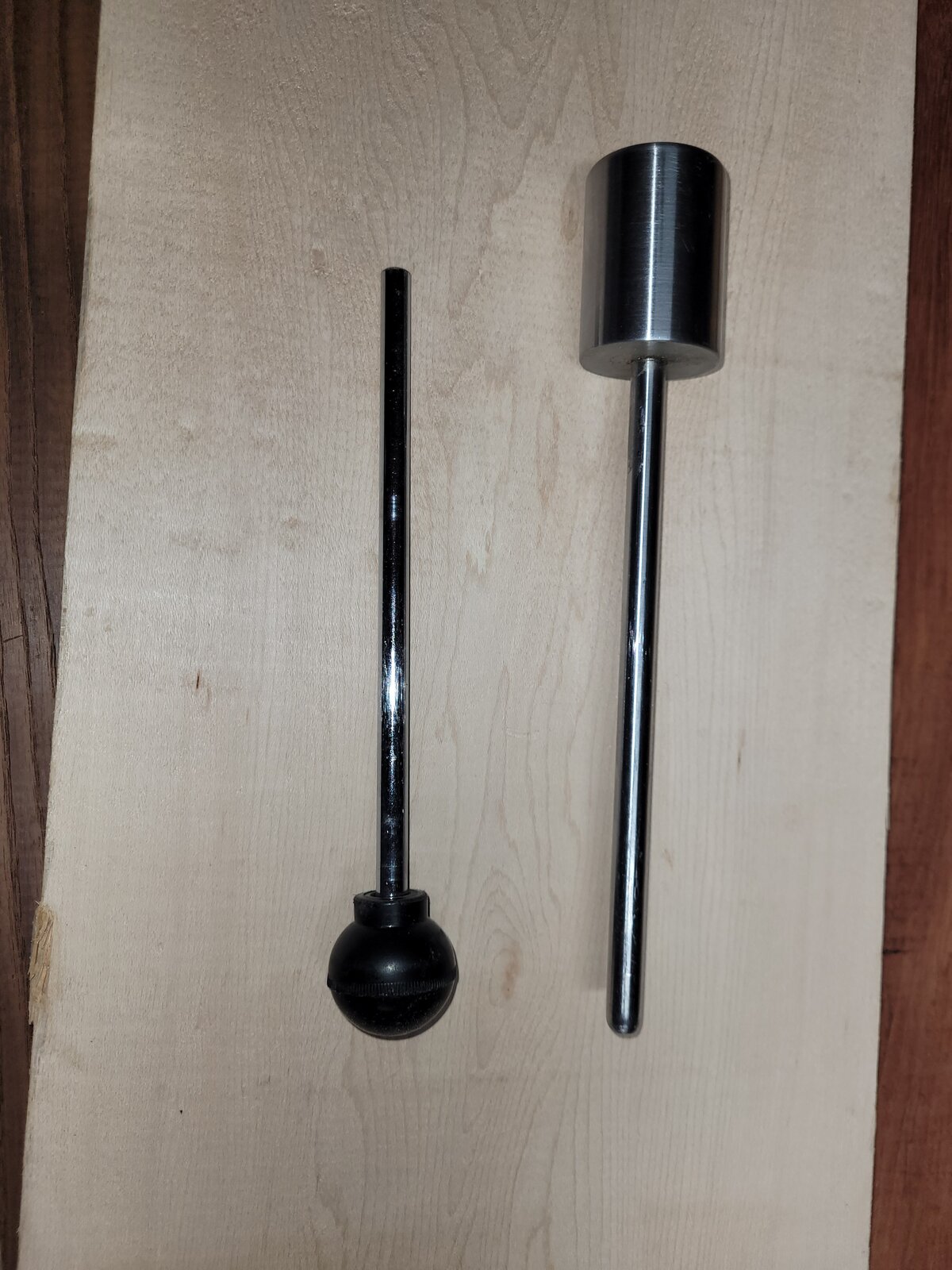

I had a similar issue with my Jet 1014. The knockout bar that came with it has a plastic head and is too light to knock the MT2 out of the headstock easily and got stuck in something once.
I made the one in the pic from a piece of 2 inch round bar and a piece 3/8" rod. I drilled and tapped a hole in the 2 inch and cut threads on the rod. I used blue Loctite so it would not come out. It works great.
See pic.
See pic.

The round bar I used is 1.5", not 2. It is heavy enough to knock out whatever is in HS or TS without banging hard. The little rod with the plastic knob was too light. And most of the accessories I have auto eject from the TS.
