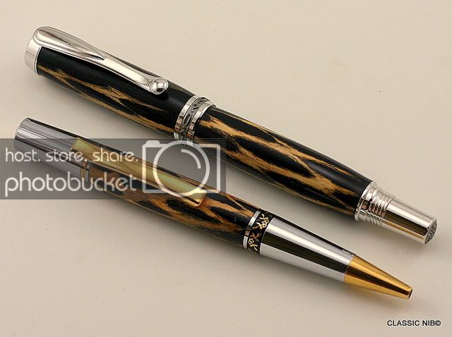

In getting ready for a few last shows this season I made a few of these.
All comments welcome.

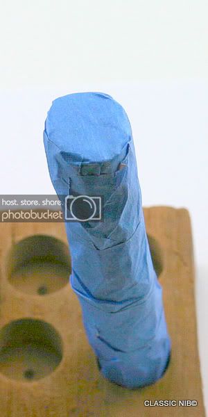

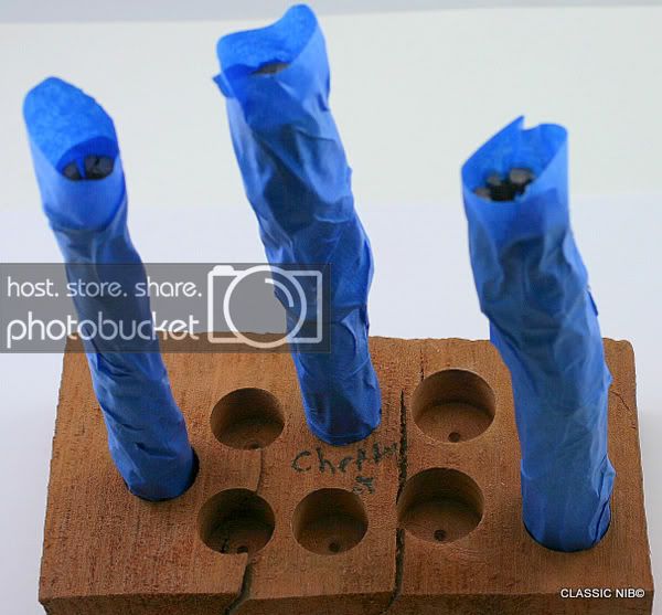

Here is the way I do it, others have their own way but I found this to work well for me. Take a scrap piece of wood and drill various sized holes with forstner bits so the cactus will stand up,. next wrap the cactus tightly with painters tape, if using PR wrap above the cactus about a half inch (Shrinkage) be sure to wrap the bottom well DAMHIKT. now just pour your PR into the cactus. With PR I don't pressure it just let it harden overnight.
Now just drill down the center and your home.Here's a couple of photos to really confuse you:biggrin:
the second one is just showing you the bottom wrapped.

Roy, Beautiful set. The cactus looks awesome on the Aero..the components tie in beautifully!! A very sweet and handsome looking couple....so... which is the Mr. and which one is the Mrs. ??? I think you need to bring them to Houston so I can have a closer look. :biggrin:. Regards, Doc
