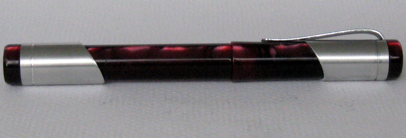

Except for the cigar clip and Private Reserve 9000 refill. I'm learning! Thanks for looking.

Chuck, I am going to be honest with you, aside from the fact that I like it, the only thing I can see wrong is the refill protrudes past the nib a little too much. Check a kit nib and put a rollerball refill in it and see how much it sticks out. If I had to guess, your shoulder hole in the nib is about 1/16" of an inch too deep. I know I will probably get bashed for saying anything but if it was me I would want this kind of feedback. Once you send it my way I can tell you more about it. I will even make sure Linda only looks but never touches. :tongue::biggrin::tongue:

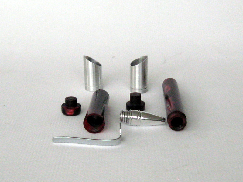

Chuck, Mike is right about this. There's an easy fix for it though. Make up a little donut spacer. Chuck up a little piece of aluminum rod, turn it down to the same diameter as the last, smallest shoulder of your refill, drill a hole in it that will slide over the tip of your cartridge and part it off a 1/16" thick or however thick it needs to be to draw that refill back in the pen to where it looks right. Slide it over the tip of the refill and stick it back in the pen.
I realize the best thing to do would be to remake the nib again. But the donut is just another excuse to play with your metal lathe. Then you can work on getting the next nib just right on your next pen.

Thanks Mike, I appreciate your honesty. You are so CLOSE to nailing the problem, I'm going to give you an "A" anyway. The drilling was spot on. But, when I parted it off the stock, there was a chunk on the end that I had to file off. It became that much short in the process. Another lesson learned:wink: And, you can join the Mrs. by the mailbox :biggrin: Thanks for your comments. And YES, DO get a metal lathe.

Thank you! Yes, I cut all the threads with taps and dies. The cap is triple start threads. I do have a metal lathe but, all threads are cut with taps and dies.

Thank you Mike. I had already thought of doing this but, I can't. Because, evrything is cut to length, there will be no room for a spacer without a gap showing in the center. It will just have to stick out a little. Next one should be better. Thank you for your help and, guidance in this fun process.:biggrin:

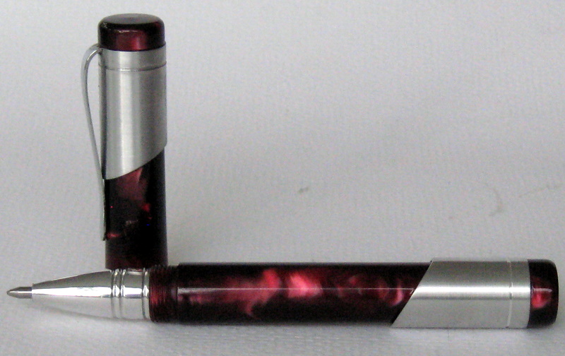

Wait a sec, is this a parker refill or a rollerball refill?
Hans, Private Reserve 9000M RollerBall refill from IPD
