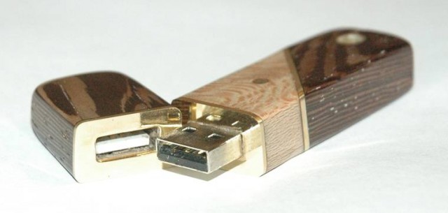

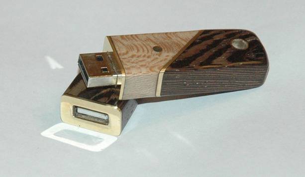

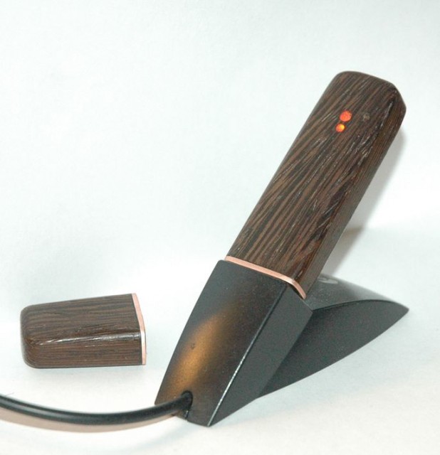

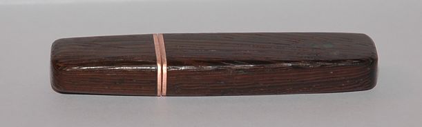

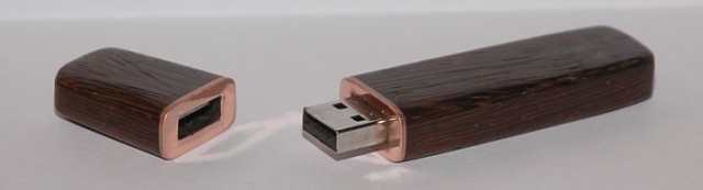

Wenge, copper bolster:
s640x480
Carnaгba wax finish.
0001dghk
LED works too:

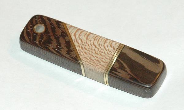

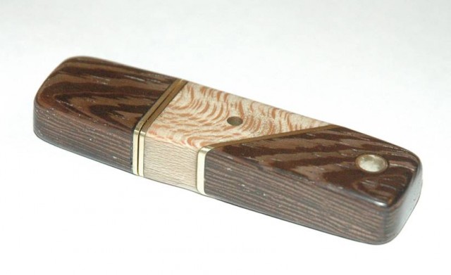

Wenge and platanus.
s640x480

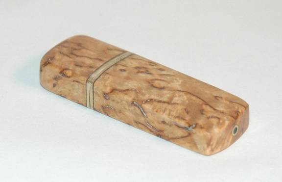

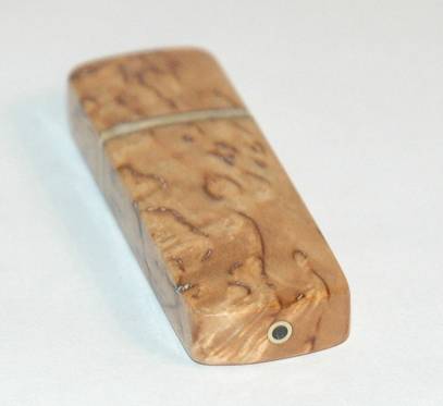

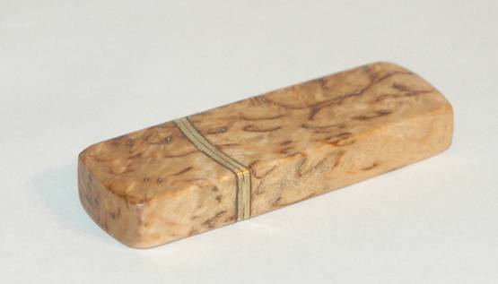

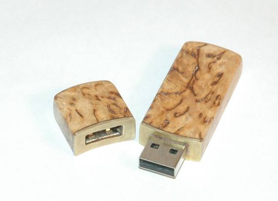

Birch burl, brass, danish oil with carnauba wax.
0004kw6e
0004p6c4

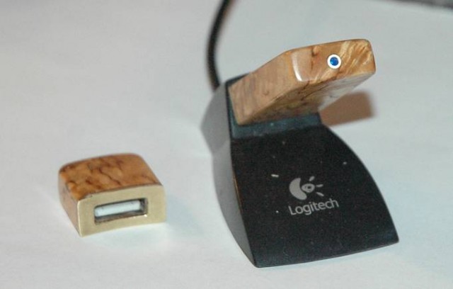

First, you need wood scale with thickness at least 9mm and width at least 20 mm. Length depends from chip size.
There is palisander.
Then you need two bolsters with rectangular hole 12х4,5 mm. You may use copper, brass, nickel-silver, leather, verneer, etc... Drill several holes make rectangular hole with needle file. You may use USB jack for reference.
I have used brass 1mm thickness.
Glue bolster to flash and socket. Usually I use CA, because it firms very fast and can be disassembled later.
Then you need cut wood scale for two pieces (one for cap and one for chip), and make holes in scales. Same as with bolster - drill several holes and use nail file to fit.
Then glue socket to cap. I use epoxy with wooden dust, but CA can be used as well.
Then you need find place for lamp hole, drill hole and glue case to chip.
And fill lamp hole with epoxy or CA.
Then you need take needle file and cut excess bolster. Or use machine sander, sandpaper for it.
Drill hole for lanyard and glue tube for it. You can made lanyard hole on cap or on side.

I am sorry, I has incorrectly translated wood title.
This is not birch birl, it is karelian birch (also calls curly birch). Sometimes birch burl call karelian birch, but it is different wood types.
