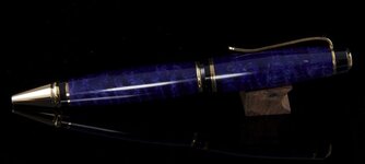

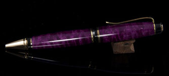

I ran into this in the past too. Even using a color correction card to make sure the WB was perfect, the pen photographed blue when it was really beautiful purple. Here are two pictures, one of the pen, the other of how it was photographed with a color correction card.
That pen is actually a deep, royal purple made using Transtint Purple dye mixed with Red food color.

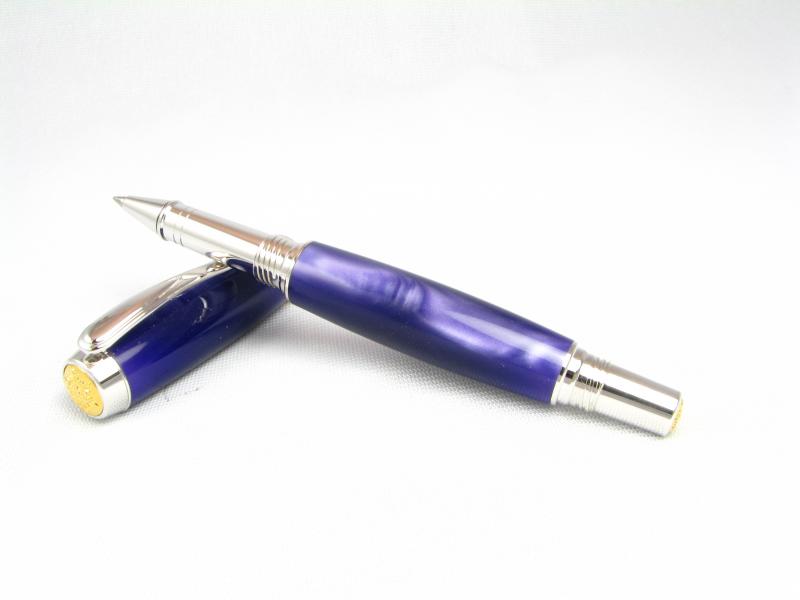

Thanks for the suggestions. I just tried a gray background and not much different. This particular pen is made from Madreperlato Purple and is definitely purple and not blue with purplish hi-lights. I also tried black with no luck. Here are a couple of pictures... one with the white background and the other with gray. Maybe the gray is not dark enough?
