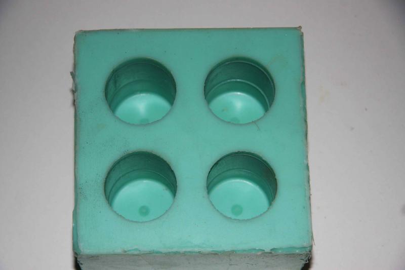

Finished mold
Here is the photo of my first silicone mold. Haven't had time to cast yet but hopefully in the next day or two. I tried to show the registration lines I incorporated into the mold as well as the nub that will make the centre hole for drilling.
Michael
