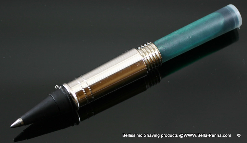

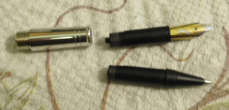

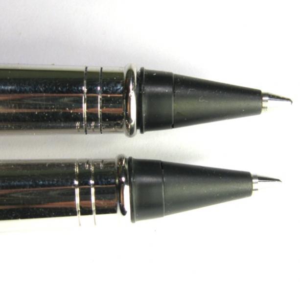

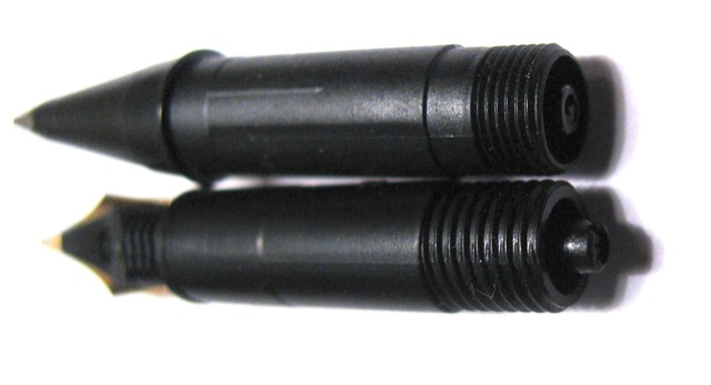

Image one contains a picture of the two nibs (a fountain nib and the replacement nib). My first concern is that although the length is appropriate, the threading is significantly different. The size appears to be about the same, but the pitch is about double on the replacement.

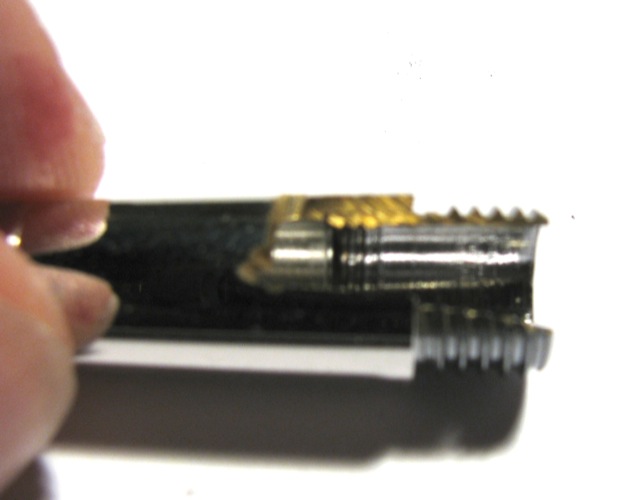

Image two shows a stock Jr Gent nib holder that I cut open with a dremel to see the inside. It is difficult to see in this picture, but the internal threads are course like the stock nib. There is relatively few threads - it appears to be about 3 times around the inside. The interesting side effect of this cut was that it made this holder work much more like a die. This holder was MUCH more proficient at cutting threads than just screwing a part into an unmodified holder.

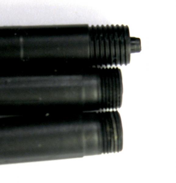

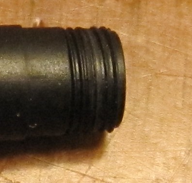

Image three shows 2 of the new nibs in holders. The top one is the unmodified holder, the lower one is the holder with the slot cut out of it. I screwed in the new part into each holder. The top part is screwed in to the point that I could screw it in by hand. When you compare it to the lower one you can see that its not quite as far in as the one in the modified holder. When I screwed in the part into the lower holder, it actually cut new threads into the plastic part. The top one did not. Image 4 will show the comparison of the effect on the threads.
Image 4 shows 3 holders after some use (inserting and removing a couple of times). The top one is the stock nib. The middle one is the nib that was inserted into the stop holder. The bottom one is the one inserted into the modified (cut) holder. It is nearly impossible to see in the picture, and very hard in person … but the middle holder has a very small amount of "squishing" on the end of the threads. In the bottom piece you can see where the cut holder has created new threads (look for the lighter "grey" coloring on the piece.)
Could this be because of any burr's that happen when slicing open?
I'd be more intrested in the shape of the female threads of the "nib holder than the refills treads. If the treads of the nib holder are not damaged I see no problem other than maybe every 3-6 months you need to replace a $3.00 cartridge. This is not an expensive part. Richard in his review said that these WILL wear out and need replacing. For that reason and that reason alone if you were to give, sell or otherwise I would tell the person using one on a component pen that the plastic treads could be damaged when taking the nib of and on. I just can't see the plastic threads doing any damage to the component metal nib.

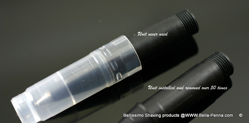

At the bottom of this post you will see two photos: The first is a photo of the cartridge with a green Private reserve refill almost used up that was new 3 weeks ago when I first installed it.
The second is a photo of that same cartridge showng the threads after installing over 50 times compared to a not used unit...I see very little if any damage.
Of course the CUT holder would damage the treads, we won't be cutting our holders just inserting the cartridge....
Thus you can see some of the core "data" that I used for my conclusions. Note that I tried to do the best I could to have pictures to back up what my eyes can see, but macro pictures at this size are not my expertise.

Roy, The threads on your used tip look real good - better than mine, but mine arn't too bad. I'm guessing the affects on the plastic threads may vary, as kit components vary.
I'll try to post a pic of my threads later.
As has been pointed out to me Soligen's and Deans threads were not as clean as mine and I've only used one cartridge on one nib housing so different results could be had by others.....
The mail arrived -- and with it a couple of the rolling riter tips from Mike and Linda.
I have a sample of 1 -- a baron fountain pen in a presentation desk pen configuration with both cap and desk base -
The baron has a tip that hold the feed mechanism of metal that threads into the body.
I have the taps & dies and use Lou's Heritance nibs - this one had not been converted so did so.
I run the 6.4mm tap though the Baron metal end piece by hand. No wrenches or clamps, just fingers, Minor resistance and a few small chips of metal were on the tap. I drill and tap holes and I was NOT cutting threads. I threaded one of the Heritance nib assemblies in to try that -- it fit nicely.
Ran the rolling riter into the 6.4 die and it fit with no visible difference in threads. Took the small ring off the Baron feed assembly (just above the nib) and checked it for fit on the rolling riter. It slid down. Tried to assemble the rolling riter into the Baron metal end. The ring would not seat all the way down easily and was removed. The rolling riter then fit snugly against the metal piece looking as if it was a match - as good as the stock fountainpen assembly.
The rolling riter comes with a plastic sleeve that clicks onto the end. Tried to fit that into the Baron cap -- not a fit so put the plastic sleeve into the spare parts bag and kept on working with the Baron.
Inked it up and tried it. Wrote wonderfully with the nice line. My wife appropriated it at that point - took a can of private reserve universal ink refills, and a leatherette holder and promised to let me know how it works.

Dennis (soligen).. Thanks for your picture and your other thoughts. I believe your picture backs up my thoughts on the thread pitch and effects. However, I hadn't tried it with other ink (just a cartridge) so that is very good info for someone who may take these further.

"could the damage be from a burr?" - Yes, it sure the heck could! However, I see the point that I forgot to raise. Once the "damage" was done, the part threaded into an un-modified holder and did so all the way. To me, soligens picture looks like similar damage was done.
"which threads are we talking about?" When it comes to the damage, I also believe the new nib will bear the brunt of the damage. The holder is brass, and although I don't believe its receiving nearly the same damage, I have NO idea if there is some or not. I honestly hadn't thought about that and didn't even attempt a close inspection.
"deans threads may not have been as clean as mine" - I don't think my picture shows it nearly as well as yours. I think the threads were similar, my 1st picture shows them best... I think there is a different answer though.

My observation is that the Rolling Riter is a "dead ringer" for the Heritance Nibs and both are identical in the die as a point of comparison.
I have found no published info on the threading sizes on either the CUSA/Daycom Jr Gent nor the Berea Baron/Seldona (which I understand is the Woodcraft Navigator - but have never purchased a Navigator) - Perhaps this discussion on the forum will generate some measurements and publication of the measured threading for the use of others so we need not reinvent the data over and over again.
The emperical info suggests that the Baron/Seldona is at least very close to the 6.4 mm thread on the tap. The $30 for a tap is either high or moderate depending on your perspective and how you will use it.
My training is to chase threads with a tap when you can (especially by hand) -- and attempt to measure threads when possible.

Do you have metric thread gages to measure the pitch on the housing you split?? That would be most useful information.

Here is what my threads look like. This happened to them the fiirst time I screwed it in, and really haven't changed since.
Dennis - is this the "damage" that we discussed with you when you ultimately discovered there were metal burrs inside the metal threads of your kit?
I think if we are looking at all of the issues so that there can be educated decisions made then we need to disclose all of the information when posting photographs and stating that there was damage done the first time a product is used. Failure to disclose starting with an inferior kit or component is misleading to that effort.
We clearly stated in another post that if you start with a damaged metal kit you are likely to have damage to the plastic rollerball writing system, specifically because of your issue. We have ONLY used this product on CSUSA Jr. Gent kits and we have not had the problem you are displaying.
The picture previously posted is NOT damage from the bad kit I had. I feel it would be inapproriate to include any information from that experience into this review. Everything I posted is information and experience I gathered after the bad kit issue was discovered and I started using a different FP to test.
I never previously posted publicly any pictures of threads damaged from the kit with burred threads, and I have never previously mentioned that issue in any public post. Those were sent only to you and the supplier of the kit. I will decline to mention the kit supplier (unless the suppier wants me to), but I will say that they took care of the kit issue, and I am very pleased with the supplier. I'm also pleased with you as a supplier.
If my response sounds defensive, it's not my intent. I just want to be clear that I feel everything I have posted in this thread I believe to be independent of the issue I had with burrs on the metal threads. I used a different FP, and a fresh new roller tip to test. My intention was not to muddy the waters with the thread burr issue, but since you mentioned it, I want everything straight.
For those curious, below is what the threads looked like when I put the part into a bad metal front section that had burrs on the threads. I want to be very clear that this is thread damage from defective kit threads, and in no way related to the roller cartridge. You can see the same damage to the kit FP part and the roller cartridge. I also have every reason to believe that the bad kit threads were an isolated issue, and not indicative of the normal quality of the kit.
Sorry the pic is a bit out of focus. This particular roller cartridge is now in a landfill somewhere, so I cant re-take it's picture.
