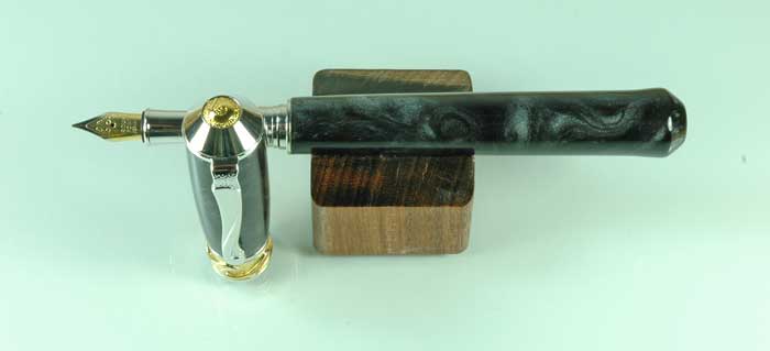

The FP on my desk is a PSI Noveau Sceptre, I like the kit. Other good choices would be any of the Jr kits from CSUSA or possibly a Baron or Sedona.
