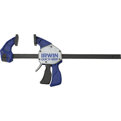

One of these....
for pressing pens together. A loop of wire keeps it hanging on the end of my stand.
  • Irwin Quick-Grip XP One-Handed Bar ClampSpreader — 50in., Model# 2021450  Buy Item# 2521450 now .jpg
