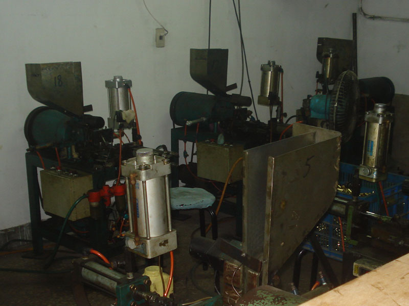

Attached is a few pics. I visited quite a few of these smaller outsource companies not with Dayacom but another pen kit maker in Taiwan. These smaller outsource business seem to be small family owned and operated businesses where the Male is the specialist (tool maker or turner) and the wife and kids + 1 labourer run the business. Their factory is small (about 50 - 100 sqm or 1,000 square feet) and the family live upstairs from the factory.
There is about 20 - 40 separate steps in making a pen kit, here are just a few.

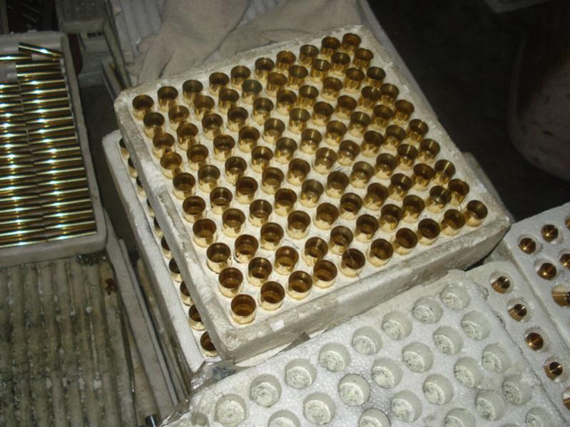

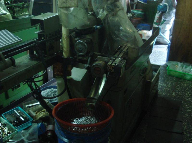

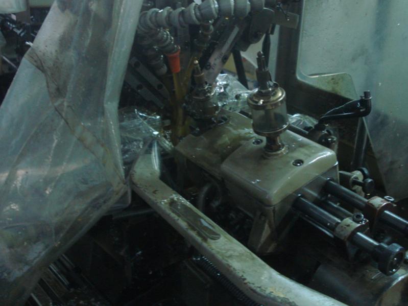

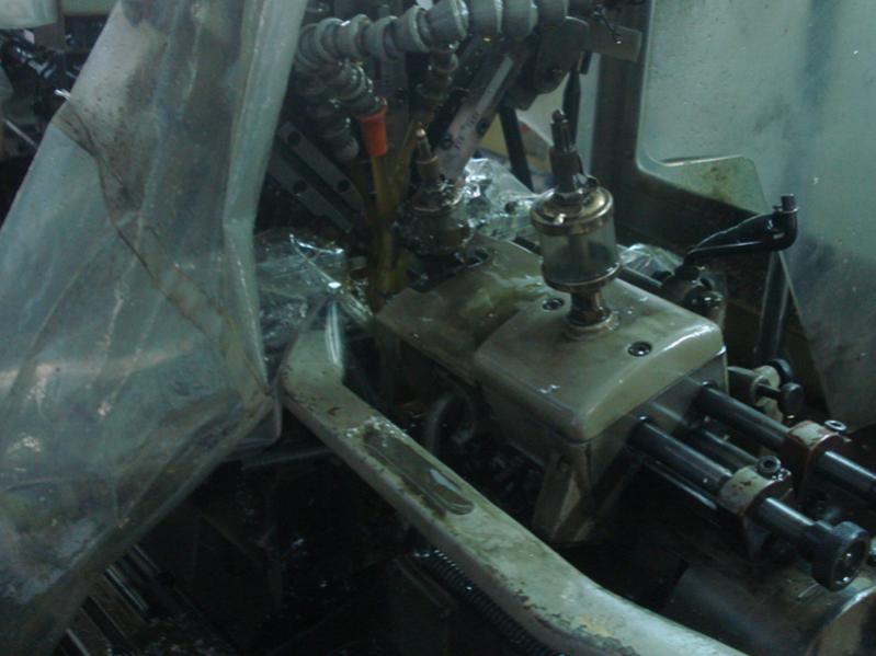

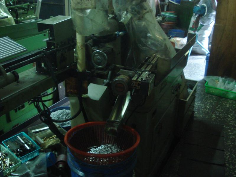

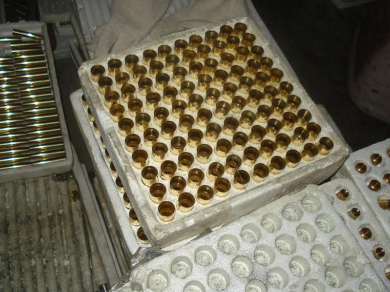

Automated lathe making bushings.
Automated lathe making couplers

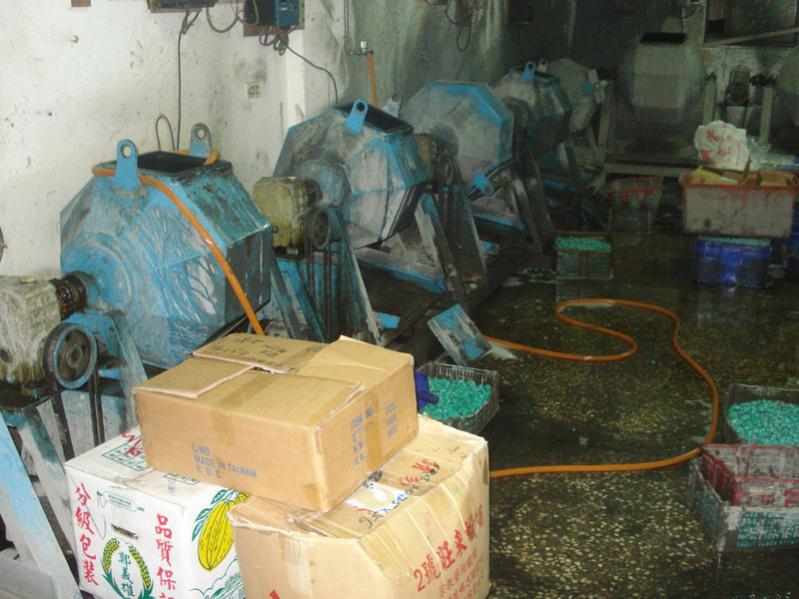

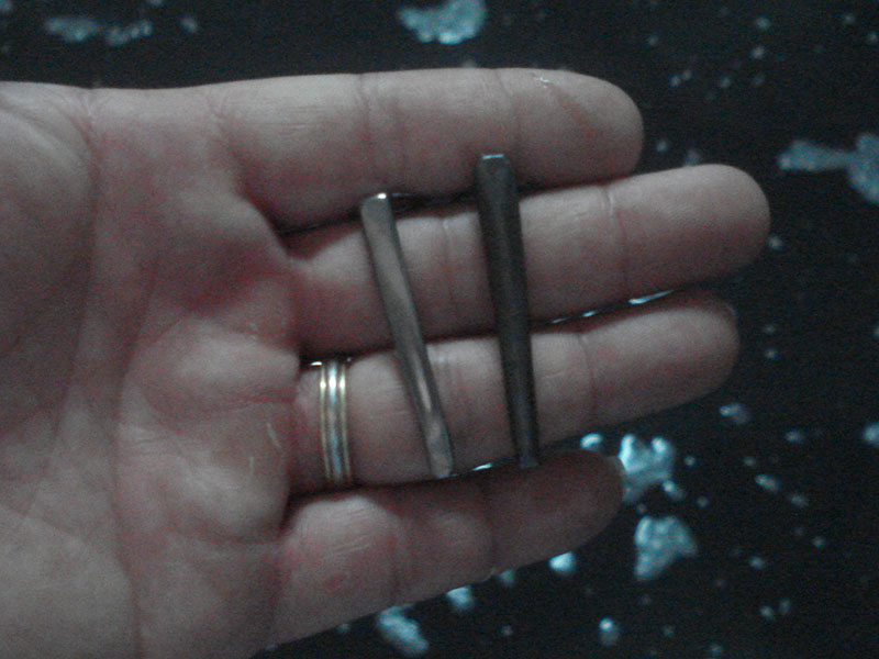

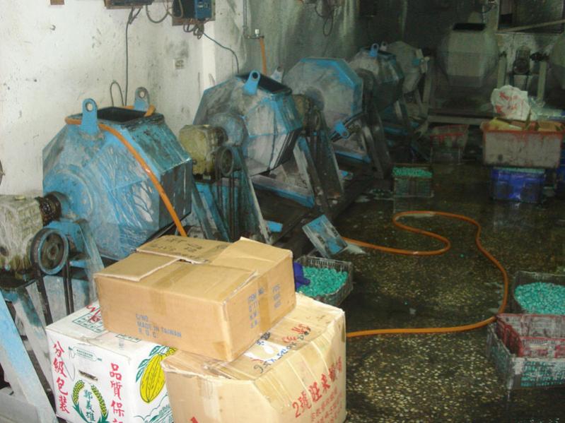

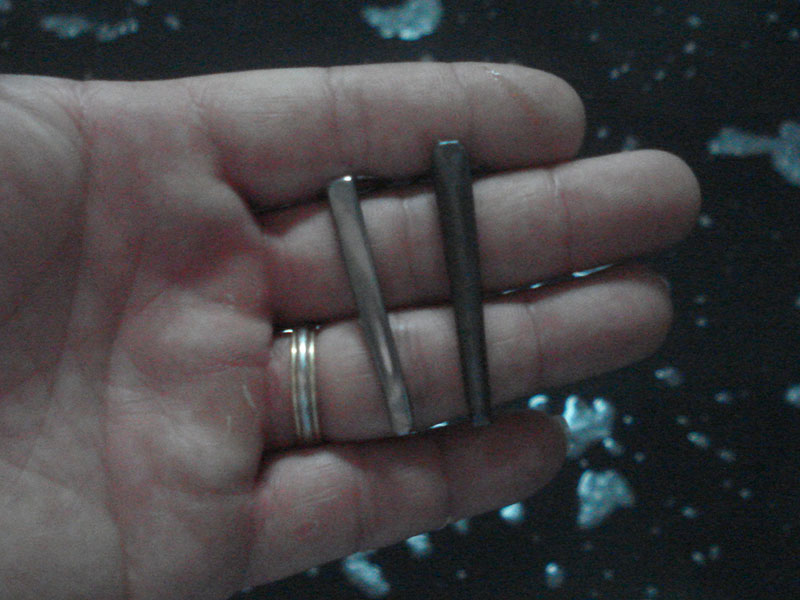

Polishing the pen clips ready for electro plating
Before and after photo.

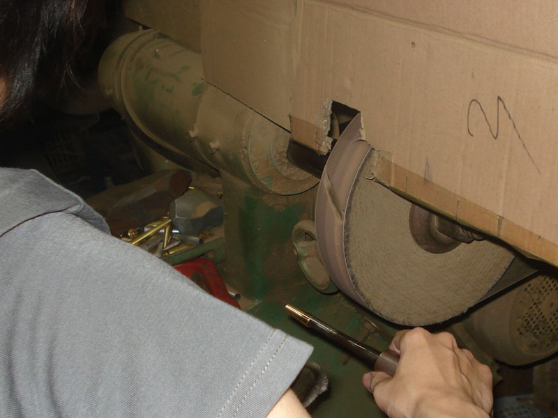

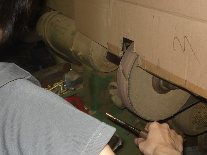

Sierra Pen Grips polished.
Sierra Pen Grips being polished
Sierra Pen Grips

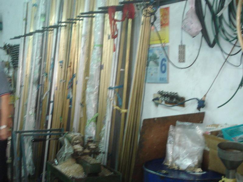

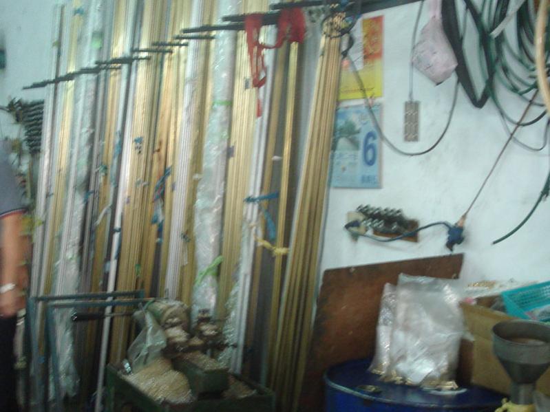

Solid brass rods ready for machining to nib couplers

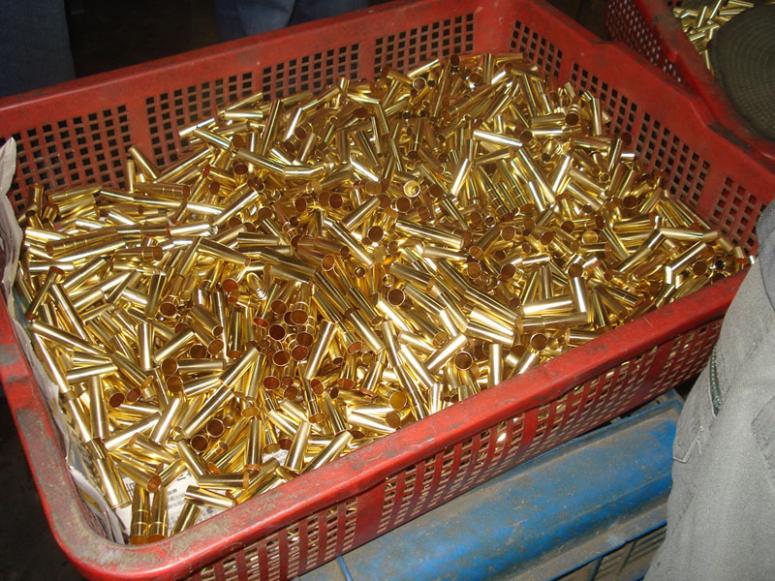

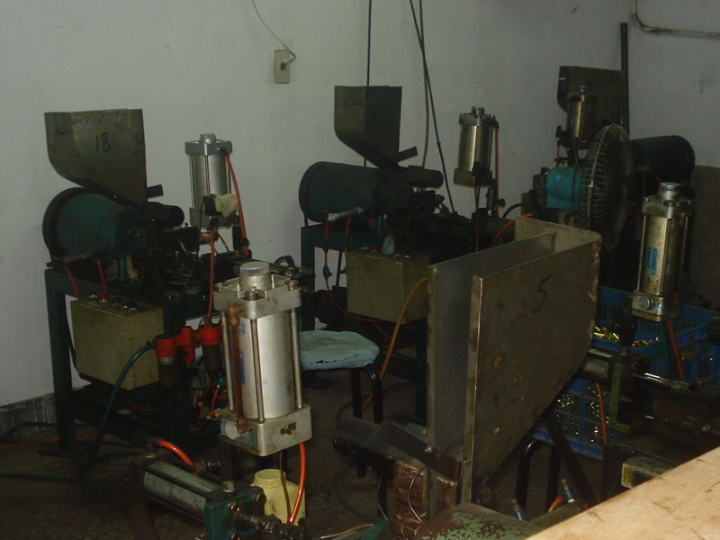

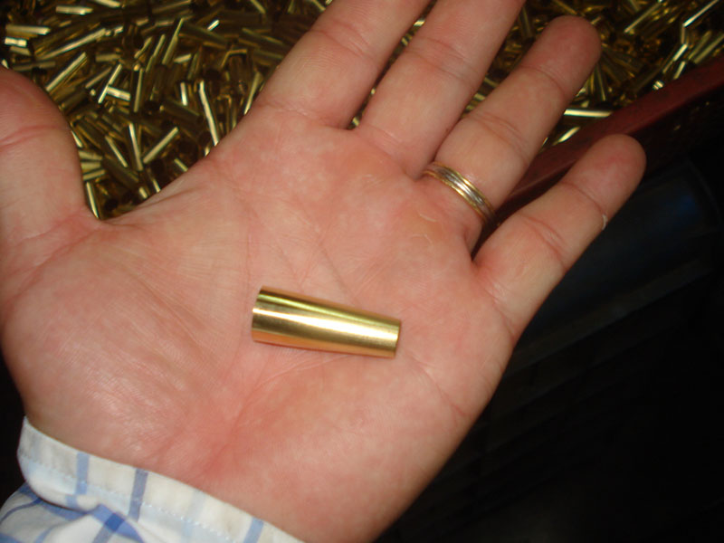

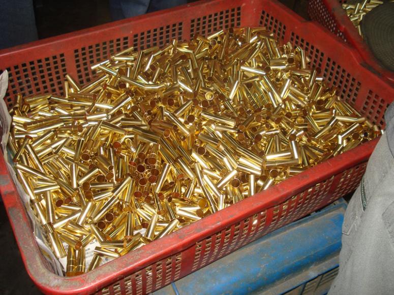

Tubes being resized into Sierra Pen Grips

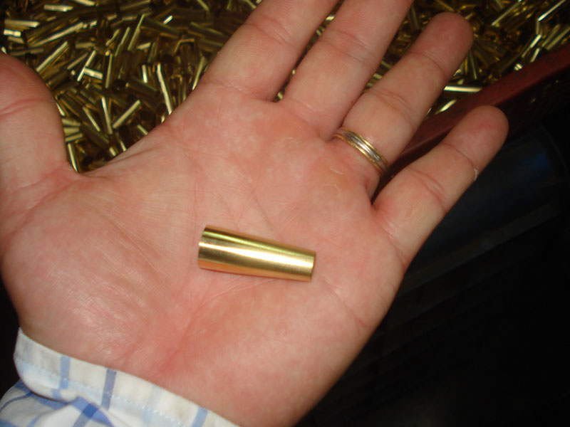

Brass tube spinning machines which puts the cones on the Sierra Pen Grips.
